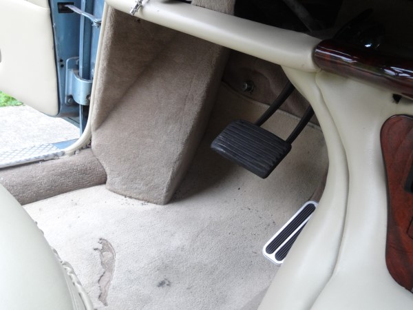

Where do people generally have their speakers in the 1960's "S" type? I have removed the transmission hump cover, and although it has two loudspeaker grills, the grill nearest the driver (U.K. Car) is blocked by the "switch" for the hot air to the rear compartment. There is simply no room for a speaker on this side.(See the upper R.H.S. Photo) and a close-up in the lower photo. I did consider "easing" the leatherette off the transmission cover, un-riveting the metal tube, shortening the support bar and operating rod, and thereby moving the "air switch" tube backwards. it does seem an awful faff!
The next option is I guess to place the speakers in the panels just in front of the "A" posts, roughly where the driver's and front passengers feet go.
Has anyone successfully located a pair of loudspeakers, and would like to pass on their experience?

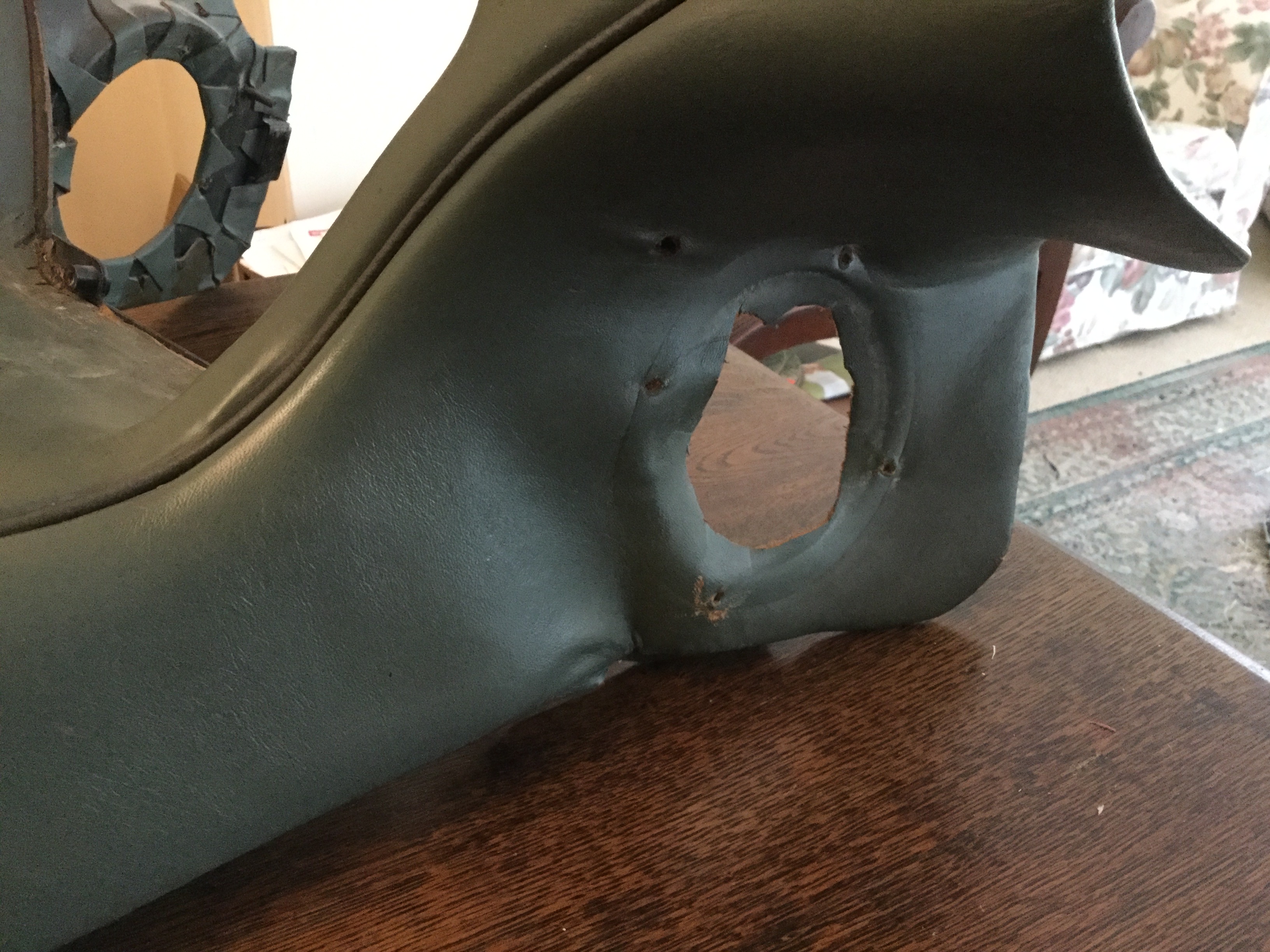

I also installed 7.5" round speakers in the "kick panels". If you remove the upholstery cards/panels, you will find two round metal covers held in place by 8mm bolts. Remove those covers and you can fit the 7.5" inch speakers there for really good stereo sound. If you layer the cavities (the inside of the front wings) with fiberglass insulation you get even better sound.
The speakers I used are the Clarion 7.5" marine speaakers, 2-way. They are fabulous. You can still find those on eBay. Then you can "fade" the radio outputs as you please, more sound to the Clarions, and less sound to the smaller ones.

I would not recommend using those stock speaker locations as those are terrible for quality sound. I made custom kick panel enclosures, hidden separates in the rear deck (all of the full range speakers are Focal separates)and 6.5" long throw JL Audio subs. I would redo the console holes in leather and cover the openings as your sound will suck with that placement. I used to install custom high quality stereos and most of your audio budget should go to speakers then to a decent amp and lastly on the head unit. my setup sounds like it has 10" subs because the quality of the JL moves big air very efficiently and the Focal are one of the best line of speakers yet I am running an inexpensive under $400 head unit and a moderately priced Alpine five channel amp

On these older cars they really did not know much about creating good sound as those factory speaker holes on each side of the center consul are the worst place to put speakers as they are aiming the sound to the doors NOT to your ears. Today nobody would be that ignorant. To get good sound in a Jaguar one basic thing is to change the speaker locations, find ways to get the sound other than your subs so that they are aimed directly to your ears. Thus it is important to think about your sound system prior to doing your interior so that you can hide your speakers and cover up any factory speaker holes so the car looks nice.

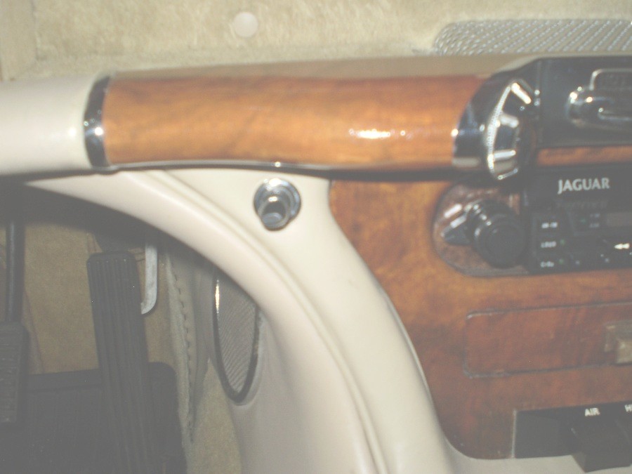

does anybody else with a S type have the power antenna switch as shown in the picture below?
mine came with the switch which is a Lucas up-down powered antenna switch. I have looked at the power antenna and it is old, 1960's vintage, with a metal housing as compared to the plastic ones nowadays.
the whole thing appears to be original to 1965 but I cannot tell if it is a dealer-installed option, maybe for California only where the car was originally exported to, or an aftermarket antenna, which does not explain the Lucas switch.

You can get electronic chrome antennas brand new today, but none of them need a button anymore to make them go up or down. I purchased a chrome electric antenna to keep it looking stock but like all modern types they are triggered up and down by the head unit which will raise it whenever you are in the am/fm tuner mode and lower it when you are in another input such as phone, CD, memory stick, or turn the head unit off. I would buy a modern chrome electric antenna and either cover up the hole or use the switch for some other purpose as you will not likely find any electric antenna that requires a switch anymore?
