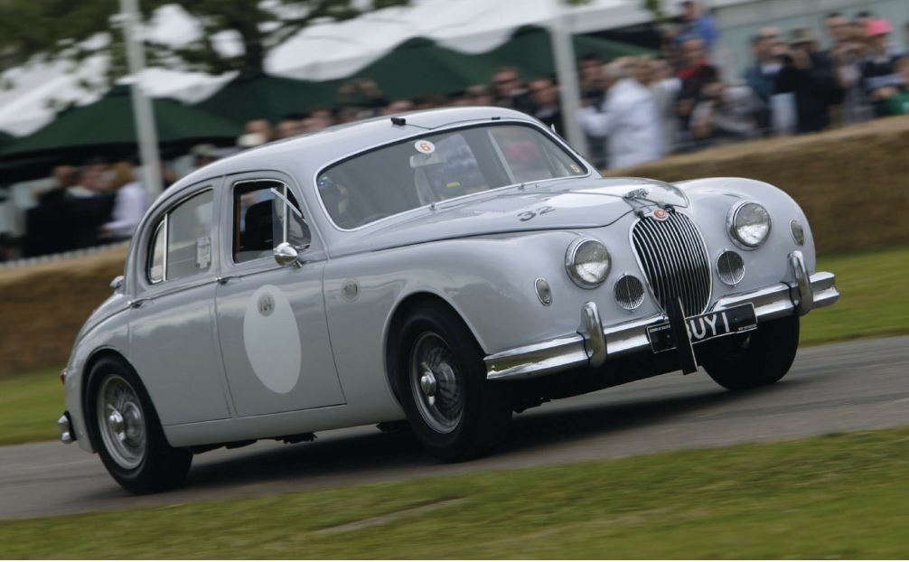

From a looks point of view we all have our personal tastes. To me this is what a Mk1 should look like with a wider rear axle fitted. This is a very good looking car to me. I also like the racing lacing of the spokes. I was very tempted at the time to go that route but wanted to enter the car in concours so I stuck to stock.

My only worry about this is that the Mk1 handles poorly/erratically because of it's narrow rear axle & this might exacerbate that. Even Coombs fixed that very quickly for the track with a wider axle.(see below)
