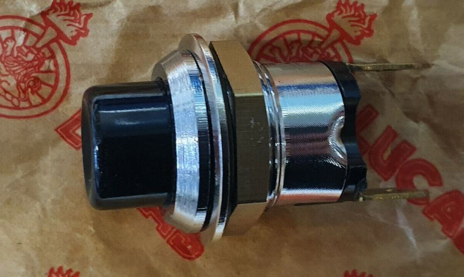

If all else fails buy yourself a new starter button. They are readily available & cheap. Mine had become erratic so I fitted a new one ~ they don't last forever.
https://www.sportsandclassics.com/pa...-xke-mk2-mk10/
