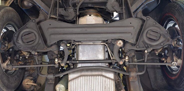

Yes. It varied by year & steering box (it's in a Jaguar Service Bulletin somewhere). My car came with the replaceable ball joints on the tie rods but fixed length. I have looked through all my publications. No tie rod lengths stated. Hopefully someone can measure a fixed ball joint non serviceable tie rod for you.
My car.

Note. The tie rods you are looking at on my car are not length adjustable ~ the rods just screw from one joint to the other without changing length due to threading. i.e serviceable. (Mine is an SA CKD built car and most if not all of the 850 units came similarly equipped)
These are the fixed rods that came on some cars. Non serviceable.
Just remove the steering wheel & re-centre it on it's spline.
