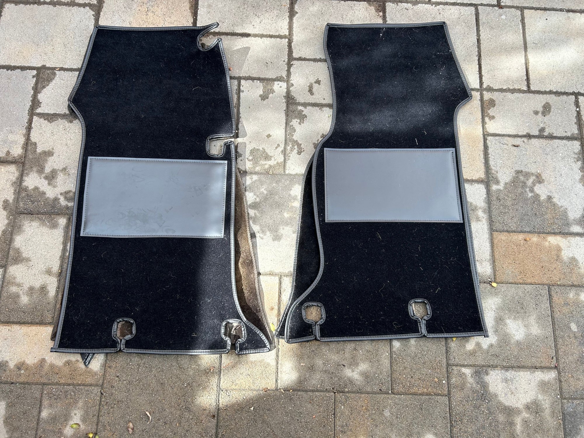

I'm in the process of installing a new interior into my 66 S Type with a manual transmission. I purchased the kit that was uninstalled and sitting in a collector's home for quite a few years and was for an automatic trans car. The kit is in great shape however when I tried a test fit for the carpets on the front floors they are much different in shape than my original leaving a large gaps toward the back by the seats. The new ones are on top of the originals. I'm surprised to see such a huge difference. Anyone with an automatic have pictures to compare?

The tunnel for an automatic car is wider than that for a manual as the gearbox is wider. Also and correct me if I am wrong but I believe the tunnel for the Auto is welded in and the tunnel for the manual can be removed. My car with a BW35 Auto box is welded in with a removable inspection plate on the left side under the carpet so you can get access to the inhibitor switch and gear change cable.
