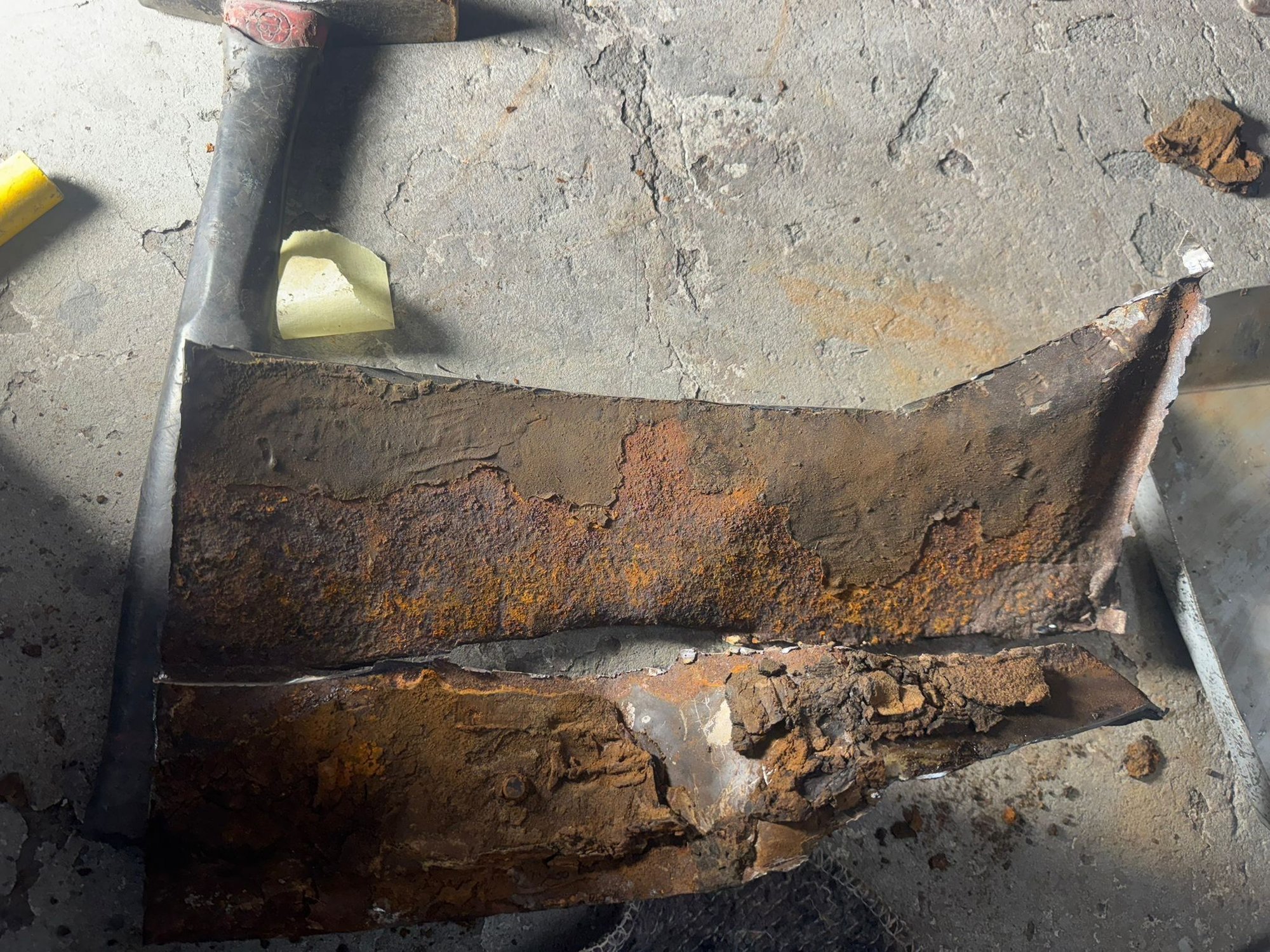

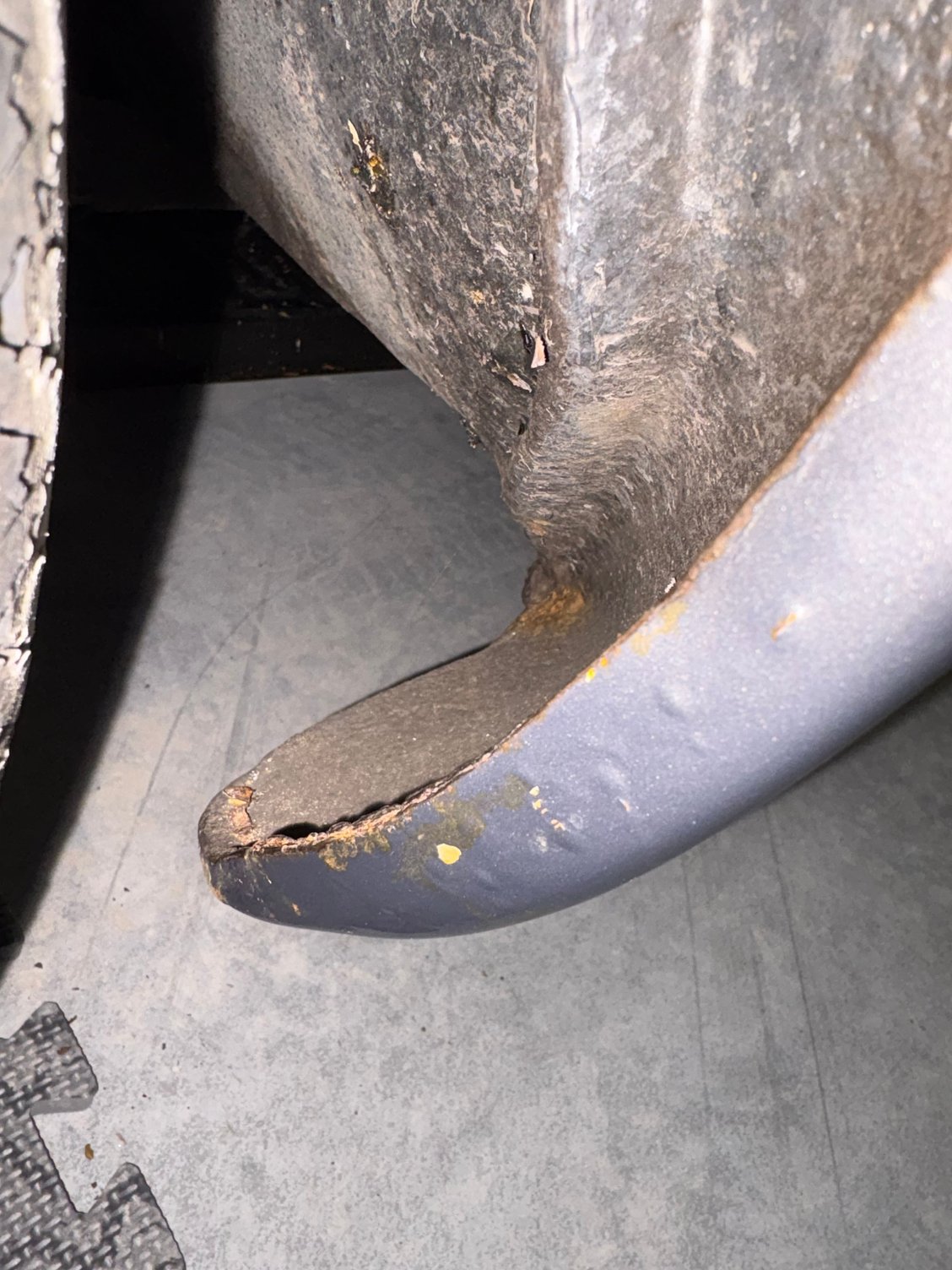

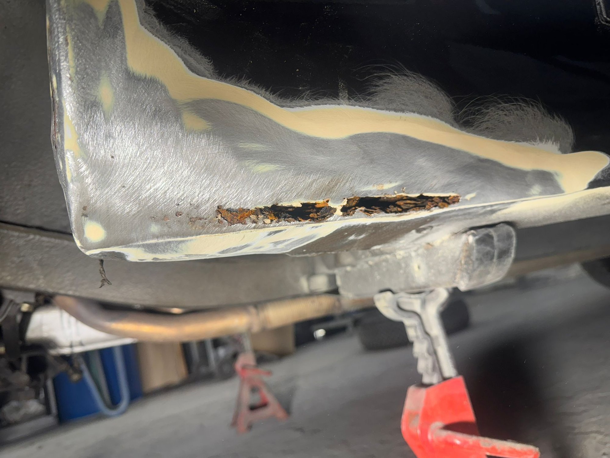

Noticed some bubbling on one of my front wheel arches.
I decided to take the car to a good shop to get it cut out and repaired properly. This is what they found.
It wasn’t just the wheel arch.
Cut out all the bad stuff
The piece they cut out is not pretty
New piece before welding in place
They are going to treat the whole area and seal
it properly so this part does not rust again.
Shows how true it is when you see a little rust bubble that usually means trouble underneath. A bit like rats, if you see one you can be sure there are more!

Where your rust is showing is a typical spot on any Mk2 or S Type. It is a sealed area where water can get into from the top, sometimes a leak around the front screen seal in the bottom corner. Once treated with a rust inhibitor and painted on the inside it should last another 50 years. One of the problems with an old Jaguar is they painted the outside of the shell but did not treat or paint the inner sills or box sections. Now adays they dip the bodies in the paint so it gets everywhere.
In the past I have, after the repair has been done, drilled a small hole on the inside of a wing then injected hot Waxoyl into the space. Once the Waxoyl is in I plugged the hole with a rubber grommet. There are other places like this area in the front wing like just in front of the rear wheel arch, the rear wheel arch itself, the area behind the wheel arch under the bumper and the sills which are sealed once welded up but it does not stop the water getting in from the top.

Another way for water and muck into there is via the so called closing panel behind the wheel arch.
Actually, yours is not too bad. Mine were close to completely missing, just a load of rust particles and mud.
