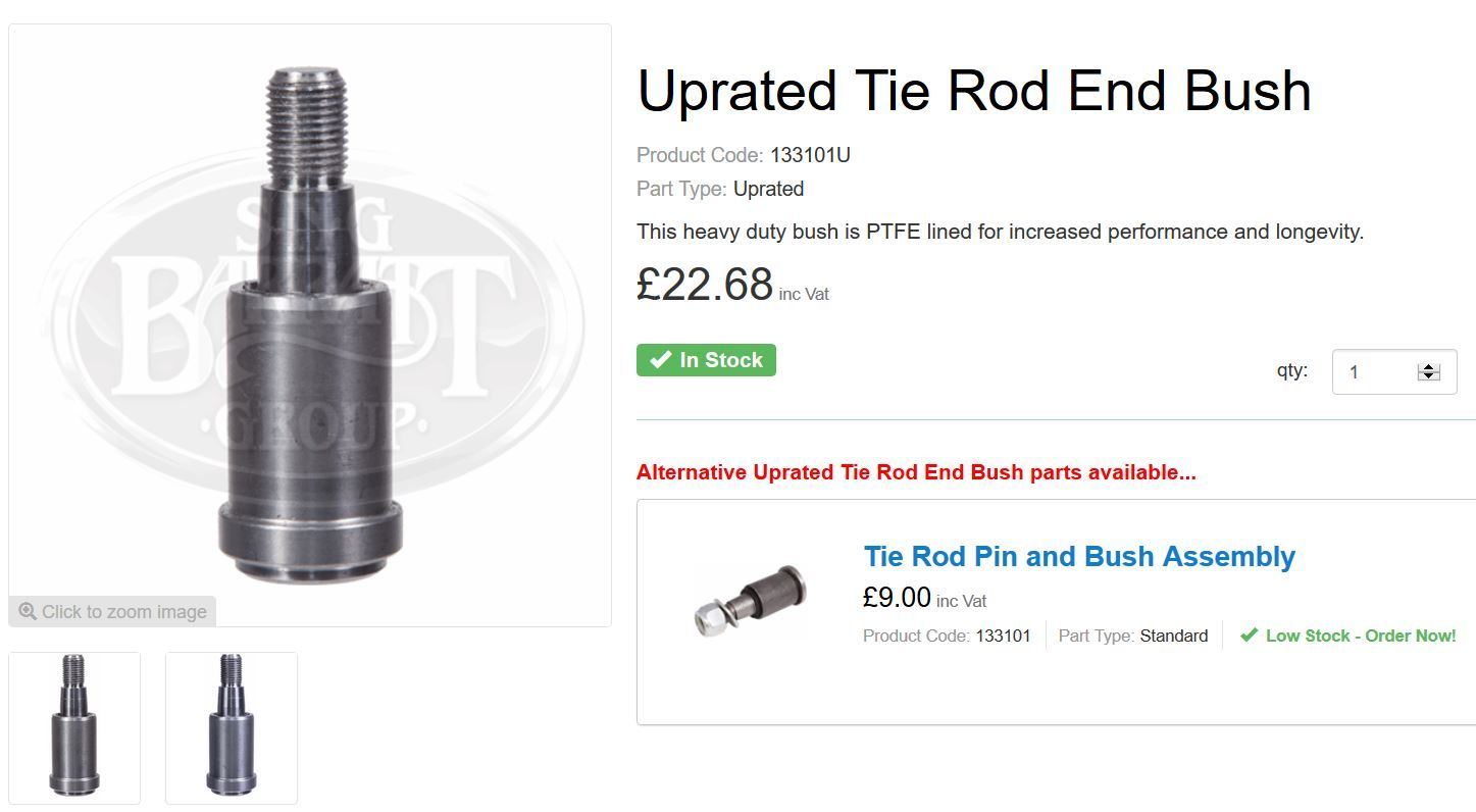

I fitted this uprated bush.
https://www.sngbarratt.com/uk/#!/Eng...1-a3c8db1911e0

I know of the "uprated" pars....haven't tried them. Read some folks ground down the outside, but I have a full set (and two more) adjustable remers in their old wood case, so I can open up the cast ends for the,
Are these ball-type inside, and not rubber?
The article/dissertation I read used some kind of US ball joint, I think, and I think the taper had to be changed in the mating parts.
If the "uprated" units are metal on metal, no rubber, I can do that.

The uprated part is TEFLON lined. As BSM states you need some compliance here or you will transmit noise & vibration. In the clamour of a race car no one cares but in a road car it would not be desireable.

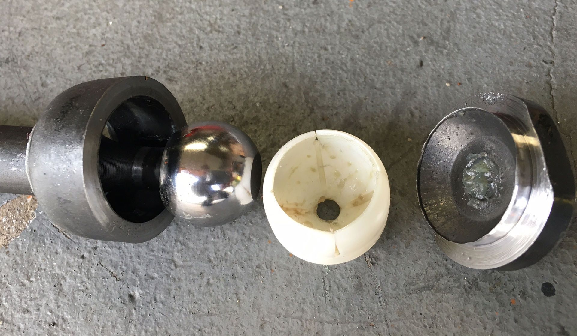

Even tie rod ends generally have internal compliance as in this photo.
