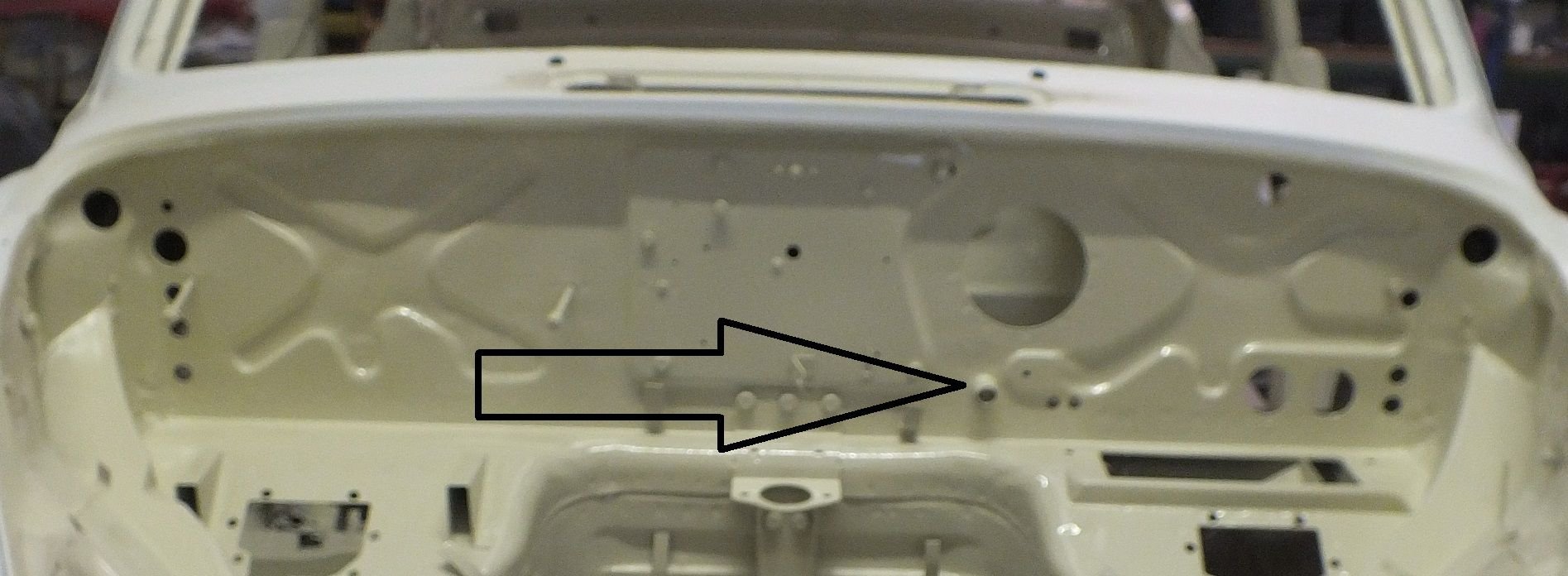

There is a drain at the bottom of the scuttle vent chamber that allows water to exit into the engine bay where there should be a long rubber hose the water flows down to the side of the gearbox. If your scuttle has been open to the elements this could be blocked with leaves and detritus but it is easily cleaned out with a coat hanger wire.
The photo below shows the drain hole coming out into the engine bay on my S Type which should be the same as the Mk2.

It is the same on the MK2. A rubber hose then drops down the firewall into the tunnel area. You need to make sure the plenum chamber is clean and rust free as if it blocks and rusts the water will drop into the cabin. You can remove the scuttle flap for access.
