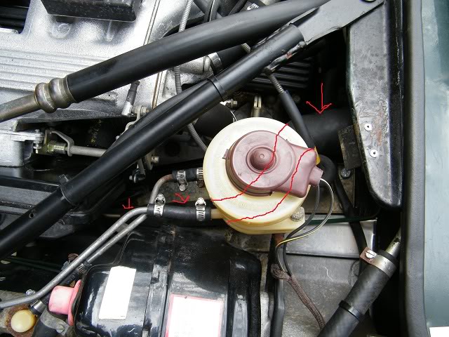

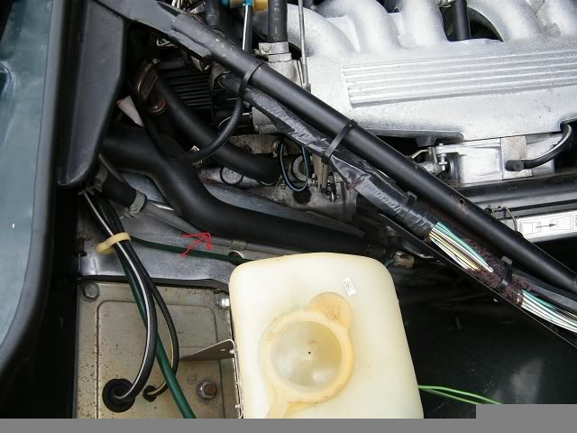

There's two drains from the cowling, one per side. You can get to them by pulling the grille out, or just pull the tubes (they should just slide together) and go up from the front. Mine had an old rag wadded up and stuffed into the pass side drain plug from the previous owner.
Here's a pic if it helps at all...

matjohns no offense but i have no idea what you are pointing to in either picture haha
Old Feb 21, 2011 | 11:11 PM
matjohns's Avatar
Joined: Oct 2010
Posts: 64
From: Portland, OR
In the first picture I drew a line along one of the tubes that drains water from the cowling to the engine compartment. The second picture is just a side shot that shows where the two drains come from.

oh so the line is actually going over the hose?
Old Feb 22, 2011 | 06:41 AM
matjohns's Avatar
Joined: Oct 2010
Posts: 64
From: Portland, OR
Next to it, yeah.

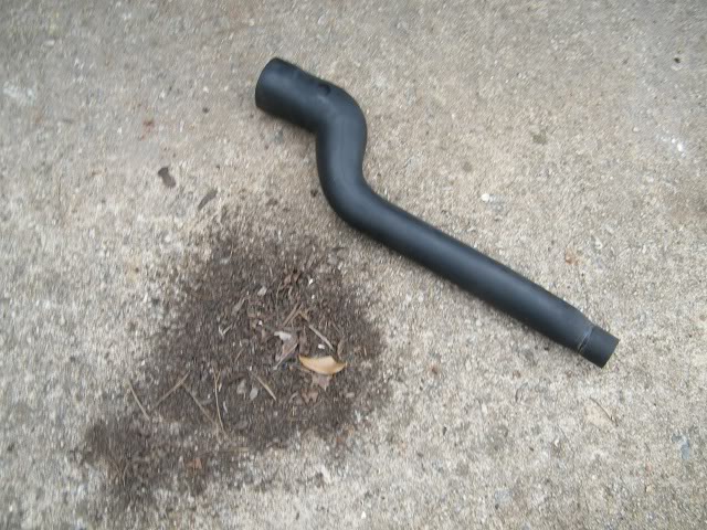

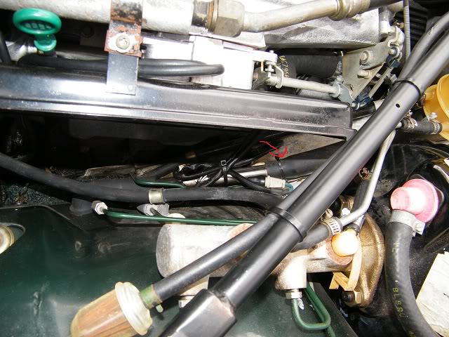

I cleared mine
out today, the drivers side is WAY easier to take off with the outer side of the air cleaner removed.
I could tell before removing them they had crap in them because I could feel leaves and stuff inside when i squeezed them.
Passengers side drain tube

Drivers side at firewall
drivers side tube with half of air box removed
My Pass side tube before being cleaned
After LOL
