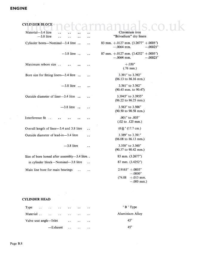

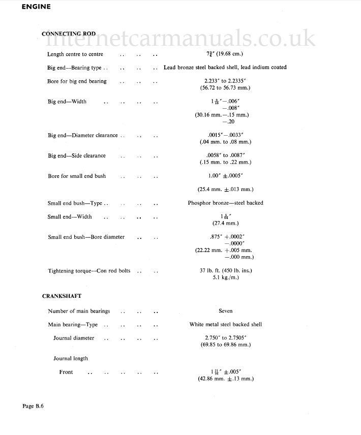

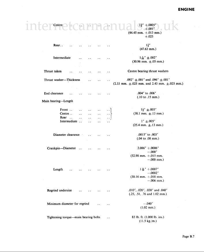

guys, Crankshaft is out, have it in my van to take it to machine shop.
but I need to find out what is/was the Standard journal size. Nothing in the manual about that.
Thanks.

Good. The first thing they must do is measure the journals, estimate minimum cut to get them to measure true with all damage removed & no ovality. & then find out what oversize bearings are available & cut the crank in accordance with that.
If you look at the Barratts site both mains & big ends seem to be available in a range from +10 thou to +40 thou (10 thou steps)
You need to have that conrod checked that the bearing spun in.
Jose ~ Read & print out WSM pages B6 onward for standard crankpin sizes & tolerances for your machine shop. Covers conrod as well. Also end float & thrust washers.

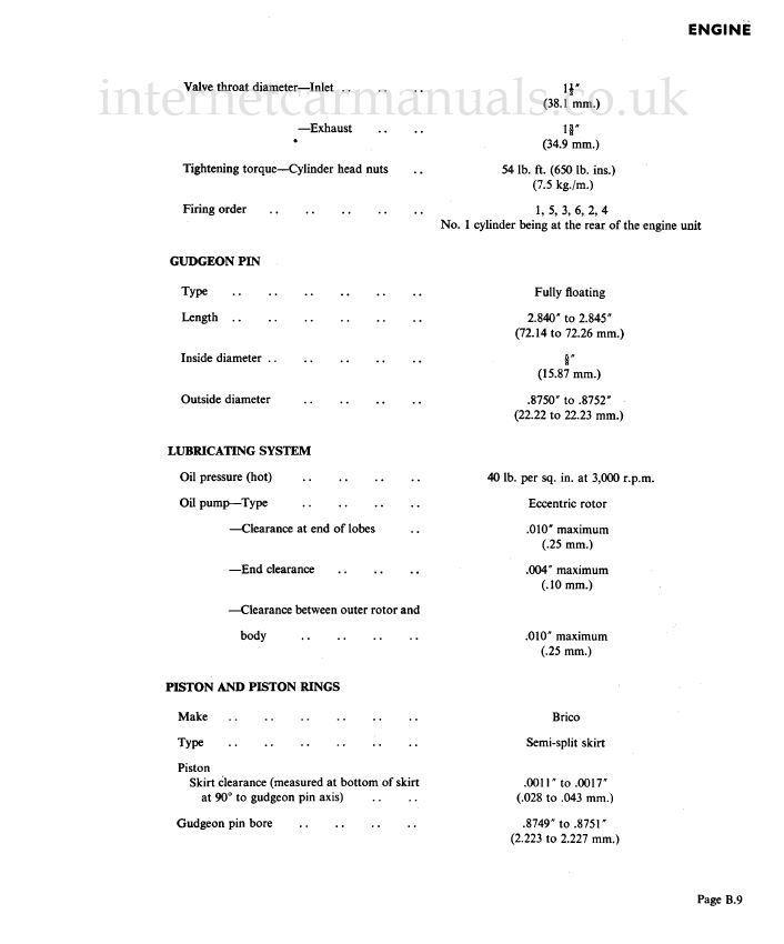

Jose ~~ in case you miss my EDIT above.
I will provide Cylinder Head/Camshaft material when needed.
Here you go.

Just in case you don't have it, main bearing journals are 2.750-2.7505", crankpin diameter 2.086", +0.0006", -0.000"

Jose ~ I've posted with tolerances above.
Old May 19, 2021 | 05:11 PM
  #160
Jose's Avatar
Posts: 9,137
Likes: 2,658
Thank you Glyn, I could not find that info previously, but it is all there.
