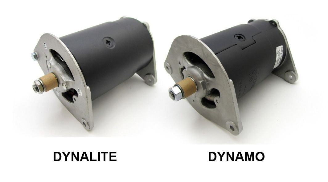

Moss Motors in Caifornia and Simon bbc in UK want almost a thousand dollars for a Dynalite.
Accuspark UK took my order for a Dynamator and then refunded payment saying they were out of stock for up to 12 weeks. What the ?
Mike Martinez of Star Auto Electric in California says he doesn't sell them because they are too expensive but he charges $350. to service a C42. haha!
I have spent hours and days shopping for a alternator conversion for my S type and frankly the best alternative I have seen is member's Jagboi64 Vauxhall adaptation that he fabricated himself.

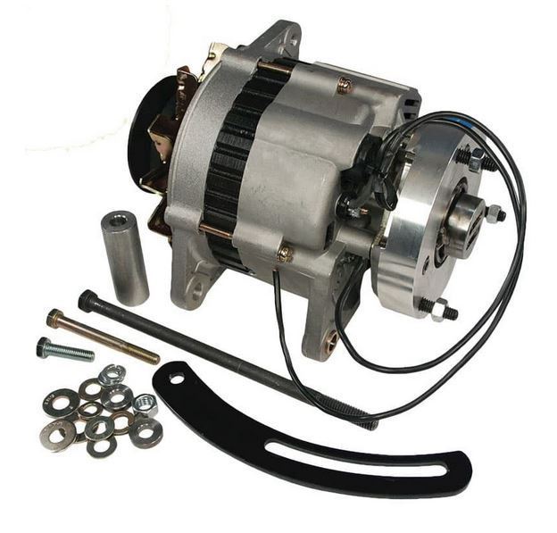

Alternative to Dynalite. Does not look like a Lucas C42 or C48 Dynamo for PAS pump.
https://mossmotors.com/alternator-conversion-mk-ii
If you want a cheaper unit and can live with 45amps. Is this what you had to wait for? Big saving.
http://www.accuspark.co.uk/dynamator.htm

Moss Motors' unit is the one I like, a real alternator with real amperes. Looks like the one built by Jagboi64
but at that price? puts me out of business.
Accuspark's unit is priced decently but out of stock for 12+ weeks. I ordered it, paid for it, and then received a refund saying they had no stock after I had contacted them by email and confirmed availability. They also have them listed on eBay UK with a big NOT IN STOCK banner. I think they are speculating. Why would you be listing on eBay if you cannot deliver?
Here's another business doing a "GenerNator" but not for power steering units. GenerNator high amp classic car alternator built inside generator

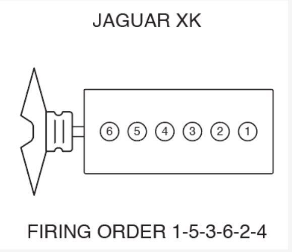

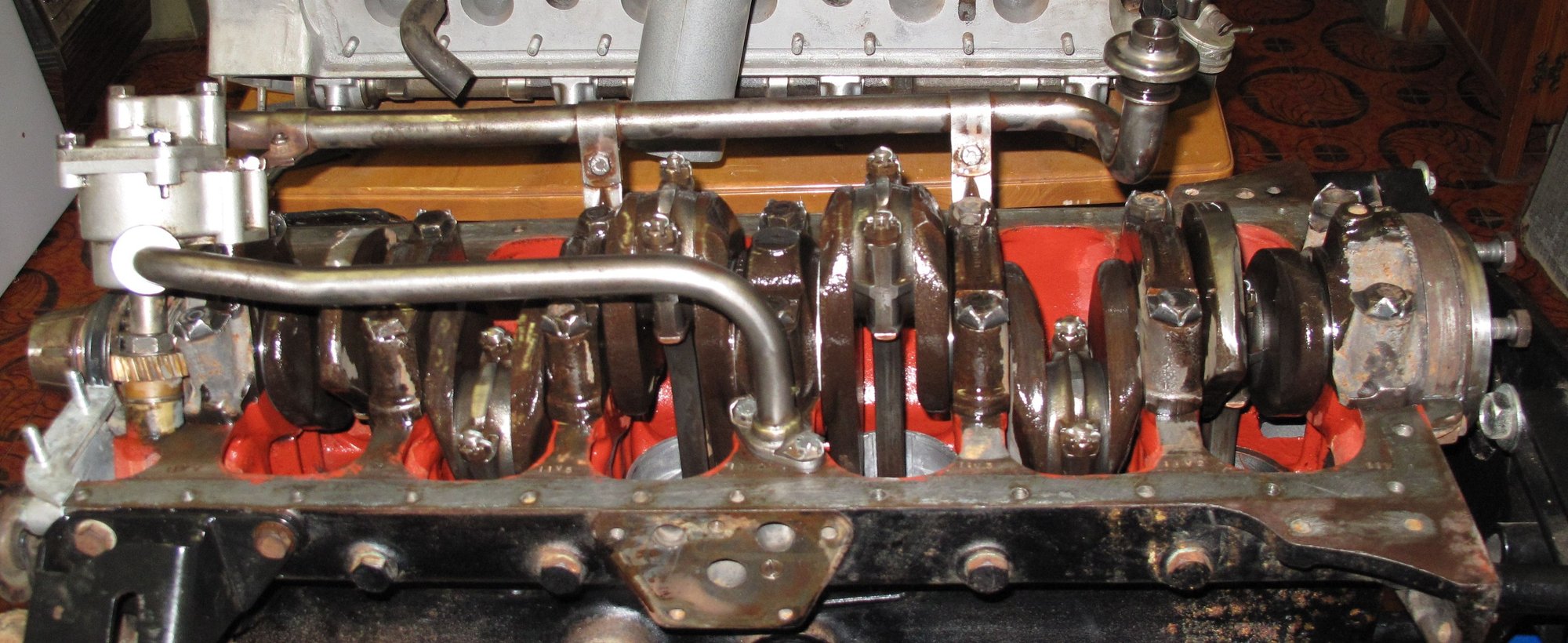

Sorry to hear that. You've got this far. Just rebuild the engine. Cut the crank & rebore. Hope the cams & valvetrain are OK. Get the head off & find how water got into the oil. Hopefully just a light head shave & new gasket. Hope the head has not corroded through. Also need to check that the timing chain cover has not corroded through behind the water pump. Common. Can be welded without distortion.
Clean out those oil galleries in the crank as I mention earlier in this thread. Remember that cylinders 1 ~ (rear) & 6 ~ (front) are furthest from the oil pump feed.
Good luck!
This was just Plastigauging the bearing clearances. Had not even painted the exterior of the block yet or plated/replaced the bolts & washers. Was fully dismantled again after this.

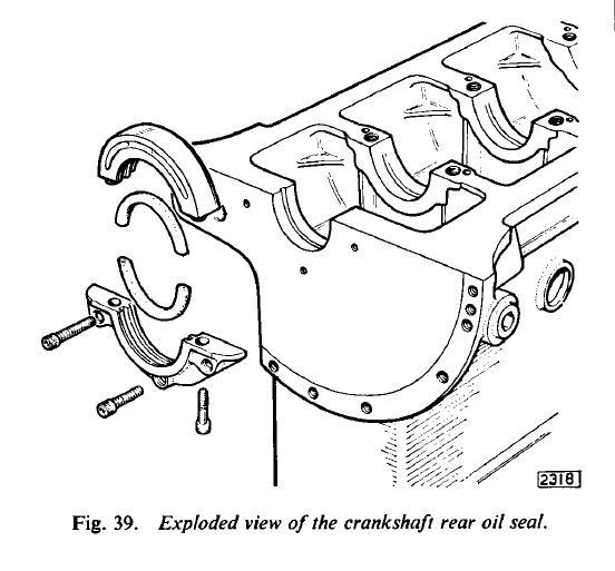

we are stuck at the rear crank seal where there is a half bracket with 3 hex bolts.
Old style seal.
cannot get the third hex bolt out, impossible.

This is the rear asbestos seal that you have. Yes?
You have the Service Manual on your website & The Register. Read pages B29 & B42, B43 in conjunction with one another & you can remove the lower seal housing & crankshaft.
3 Allen cap screws hold this to the block (upper seal housing)
Apply some heat to the stubborn cap screw. Use a BFH with high quality Allen key to loosen. Add strong tube to Allen key to increase leverage if needed.
Good luck! Yet another seal housing was used in 1959 but your car can’t have that. Too new.
