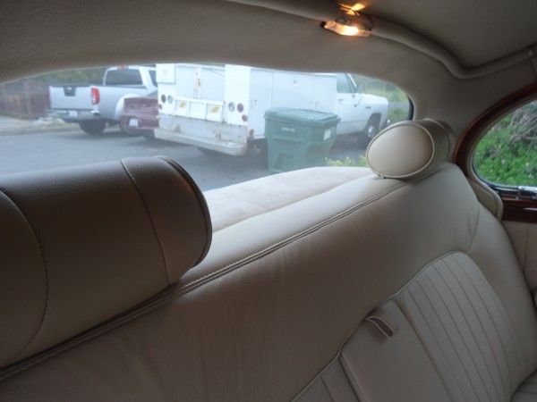

This was the standard factory rear mount speaker & grill if so ordered with a balance control front to back. Those are lights reflected in the rear screen ~ not wires.

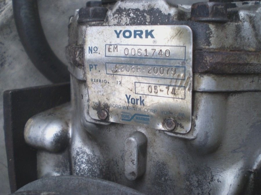

I have a a/c that I pulled off a 1964 MK-2,
A YORK compressor dated 1977 with a long support bracket and double pulley, a small behind-grille condenser and brackets, hoses, and a under dash unit with evaporator from 1970's too. The compressor condition is unknown. I only pulled it for the parts references. It probably is bad.

Why don't you have the compressor checked and ask for a quote to repair it. You don't have to go ahead with it if you don't like the price. I personally like swash plate compressors but you will probably never be happy with what they cost for a good one like a Denso.

Good idea Glyn, except I don't know who could check it around here. Here's some pics of the parts less the under dash unit.
The condenser is pretty hefty as you can see in the picture. There are three brackets, one is hidden behind the compressor.

Jose one thing you might find interesting is unless there is internal damage (broken piston rod or cylinder damage) all of the parts are readily available to rebuild a York. Normally head gaskets and seals are all that is needed--very simple and in most cases can be done in situ.
+1^ ~ Yorks are tough old things.
