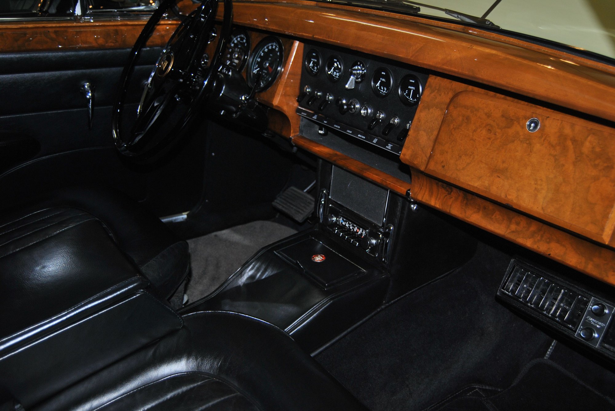

I was thinking of Gregory's Mark 2, that had dealer installed AC and is an underdash unit similar to the link I gave to Rockauto. His is a Canadian delivered car, so different AC than US dealers developed. I have worked on the AC on his car, and the compressor and mount is the same as the Jaguar drawings in the JCNA air conditioning guide.

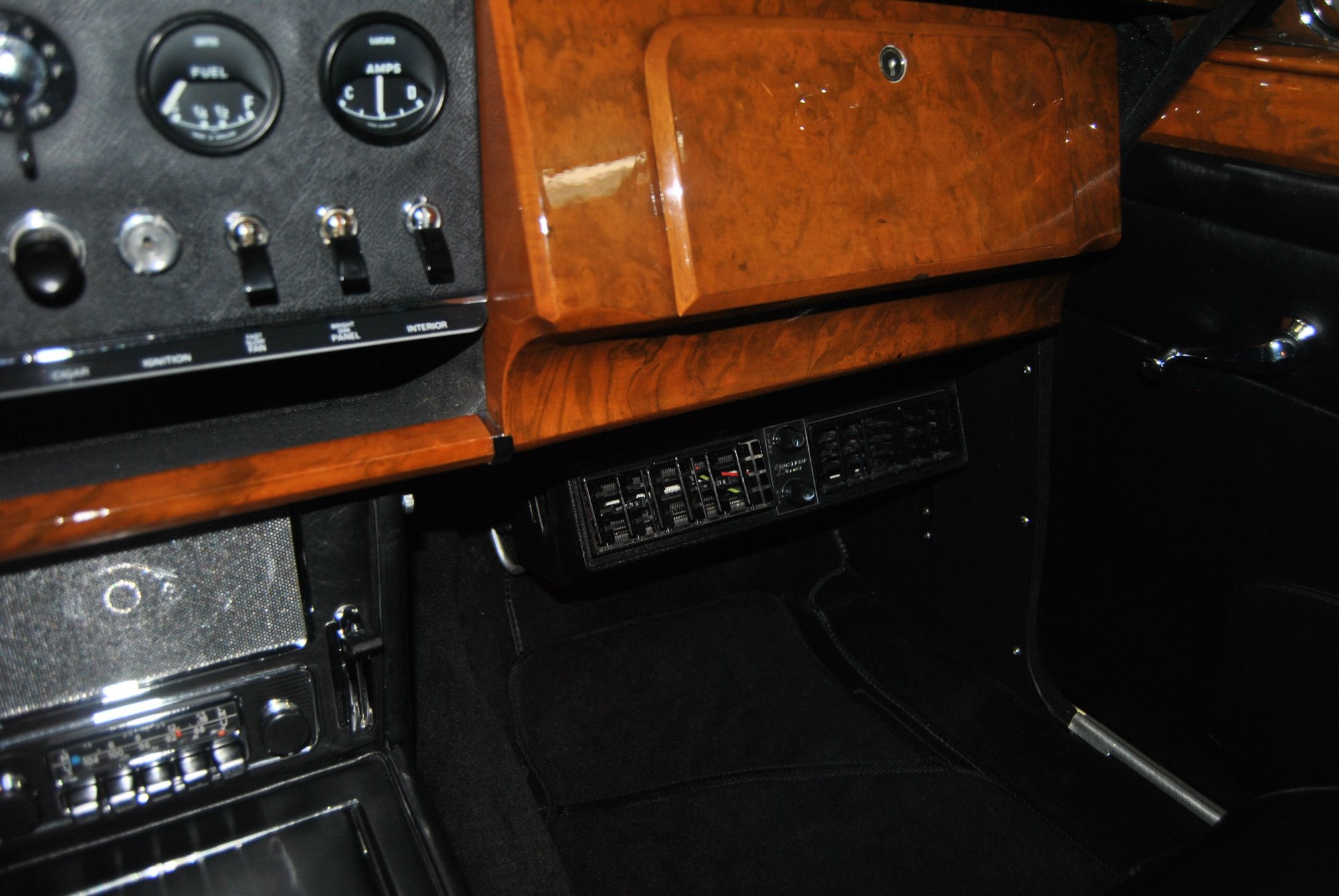

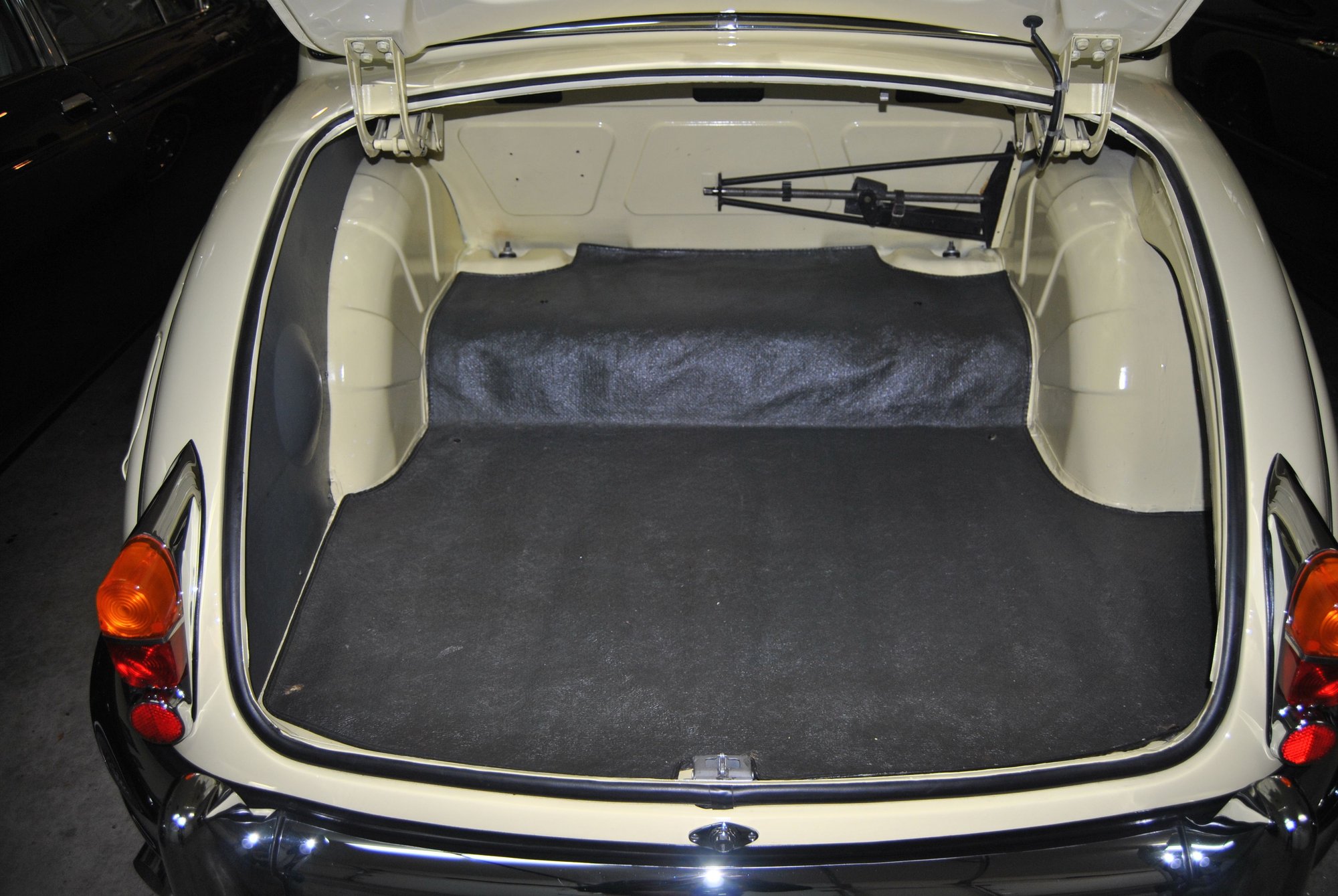

This is the dealer-installed (in 1966, Motor Sales, Winnipeg) AC system in my Mk 2 referred to by Craig:
Nothing in the trunk:

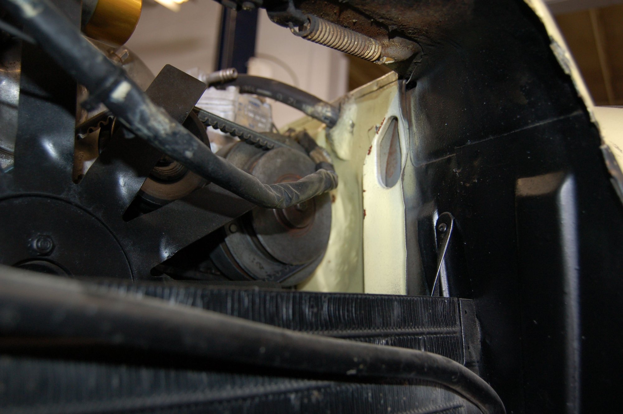

The original York compressor, converted to R134A; and as by 1966 Jaguar had foreseen the installation of AC compressors, this car has the factory indentation in the inner fender; the air produced by this system is icy cold (unless there is a refrigerant leak!):
The fender indentation is hard to see but the compressor pulley fits into it nicely (this is a pre-restoration photo): You can also see the AC condenser quite clearly at the bottom of the photo.
And a detail of the cabin unit:

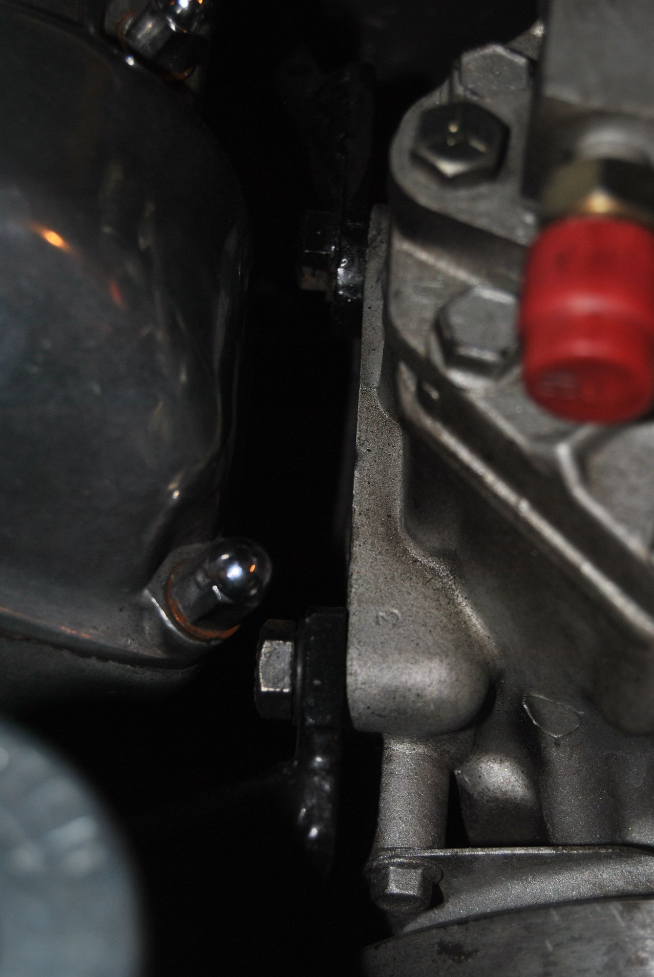

A poor photo of the compressor mounting bracket:
and another equally bad photo of the mounting bracket:

Ah! Gregory's loverly Mk2 again:
That is a very compact unit for the era. About half the size (mainly length) of my late mother's '65 Chrysler Valiant unit.
Gregory
1) Missed it ~ it has been converted to R134A refrigerant ~ what effect? ~ Replacement on the way again.
2) Would it achieve comfort in Summer temperatures in the 30°C / 86°F range?
3) Is the only mod to the car the Compressor pulley dimple in the inner fender for cars without?
4) Where does it draw it's ambient/fresh air from?
5) Does it have some sort of idle compensator when the compressor clutches in?

Glyn:
The conversion of the system to R134A produces very cold air - but I had not recommissioned the system with R12 previously so I cannot make a comparison between the two refrigerants in this system. And yes, in 30 degree temperatures the cabin is very comfortable - in fact after a bit it becomes too cold.
As far as I am aware the only change made to the Mk 2 body was this concavity to accomodate the compressor pulley, and I think that was done around 1964. Here is a more clear photo of the concavity (please note that the engine bay of this car has purposely NOT been restored to concours condition. I want to use the car - and I do - and I wanted to do nothing that might inhibit such use); you can see the outline of the indentation to the right of the pulley bolt:
and a clearer photo of the mounting bracket:
Fresh air: this is drawn in simply by opening the scuttle vent.
Idle: while the York compressor has been described by others as a "thumper", to be honest it is very difficult to determine when it cuts in and out on this particular engine. No idle compensator has been installed and the engine does not falter at idle with the compressor on (but the amp meter obviously records a discharge at idle with the AC on). I should note here that the car remains on positive ground, and that it uses its original generator (C.48 high output fitted to Canadian cars from chassis 223984 - mine is 224363) - there has been no alteration to the charging system (yet). I have to say that given the antiquity of the system, it works amazingly well (when there is no refrigerant leak - Craig may want to comment further on this). As a matter of record the car today has just 27,056 happy miles on it.

Thanks. Goes to show you don't need these monstrous things & did not even back then. Jose can confidently fit a unit that saves an awful lot of space as I suspected. Trouble is those huge lumps actually hark back to the Mk VII if you do some research. All he has to decide is if he wants a compact evaporator front or back & where he wants the cold air to enter the car. I fully understand now how your system is configured. The XK engine has a heavy flywheel/TC Flexplate & crank so the York does not disturb it. In some vehicles those York reciprocating compressors could kick up quite a lot of low frequency vibration. Thanks again.
