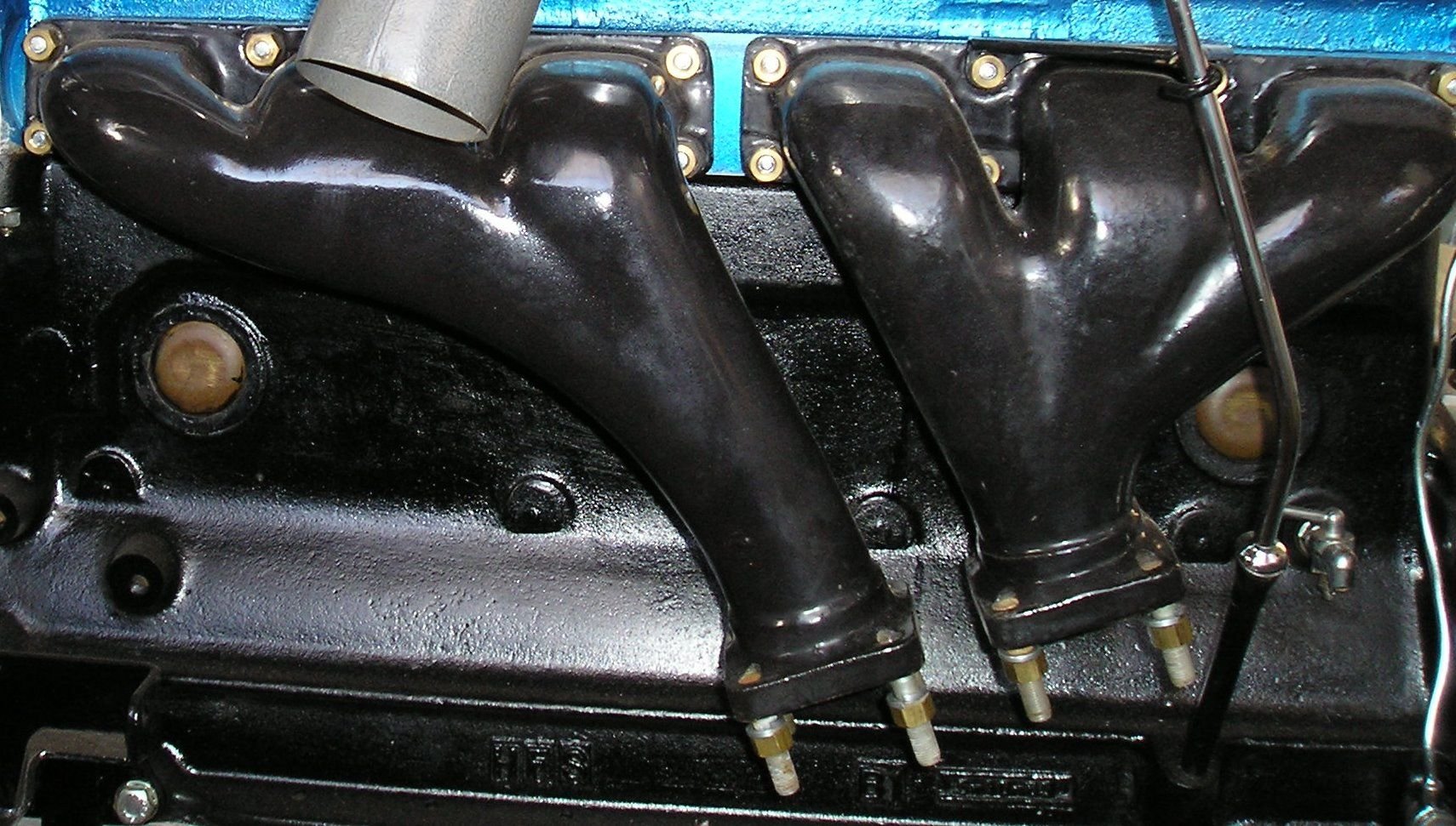

the flange nuts are steel, not stainless, not brass. Maybe that is why they are so stubborn. Once loosened, they came out alright. but getting to a few of the nuts that is another story. Frank took a few off then I took the rest off. remember when I installed the Bell exhaust in 2005 I had to use a number of tricks to start the nuts, then other tricks to tighten them.
One of the flange ears is broken off, I have a solid pair of manifolds from a 1964 S type but the porcelain is gone on those. And I cannot afford to redo the porcelain, so I will just paint them and the heck with it.

My flange nuts were brass/bronze so I replaced them with brass as you can see. Maybe it was a running change. Suggest you replace with brass.
