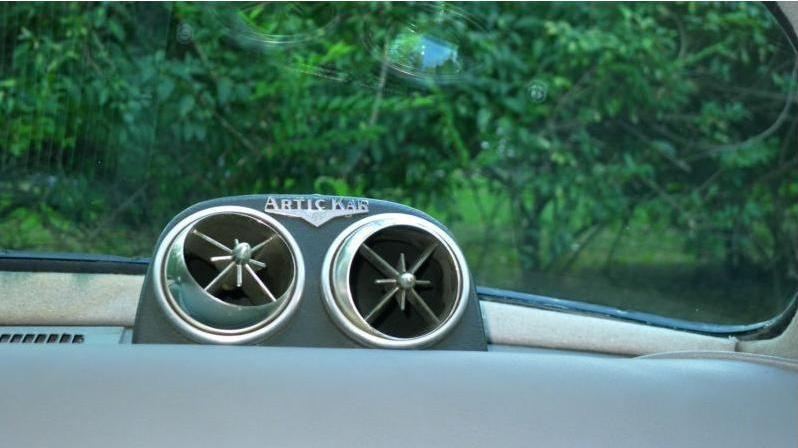

Jose ~ just giving this some thought overnight. Why don't you talk to a top automotive HVAC shop. Fit a modern efficient swash plate compressor in the traditional position & condenser with electric fan in front of the radiator designed to run on R134A or one of the modern refrigerant blends. Modern condensers are compact. (no need for the "chair" condenser). Still fit the evaporator in the boot/trunk. It will take up a fraction of the space (likely less than a quarter of the original) & put a neat cover over it. There are a number of removable metal panels in the rear parcel shelf for outlet vents/speakers etc. without butchering the car. A neat duct could be made up to connect them to the evapourator output that you would hardly see (or use a Mk2 front duct) & visible cold air outlet grills in the upholstered shelf just like original but not obtrusive. You could even use your genuine controller if you are happy with just temperature & fan speed settings. (and no stupid temperature control knobs in the middle of the rear parcel shelf like some had that the driver could not access). Remember the evapourator needs to draw in ambient air & blow out cold air.
The joys of a swash plate compressor is they rotate all the time from pumping zero refrigerant fully variably up to maximum output dependent on swash plate angle which is defined by your temperature control setting. No noisy clutching in & out & excessive messing with your idle speed.
This would give you a highly efficient modern system designed to run on modern refrigerant without any ugly mods or considerable negative effects on gas mileage.
Just a thought for consideration. Best of both worlds.
You could either use flat outlet vents in the parcel shelf that uses the rear window to deflect cold air over the dome or seek out a set/pair of these.
S Type Artic Kar.
