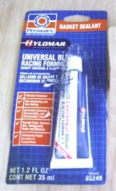

On the rebuild of the fuel filter I have some weeping from one of the Banjo connections. I have replaced the fibre washers and I do believe the problem lies there but is there anything else that you lot use instead ?

yeahh, you need to find a way to tighten it even more, it's always a problem.
try a light film of Hylomar on each side of the fibre washer?

Thanks Jose,
I will get some today and give it a whizz ;-)

Hi Chaps,
I did what Jose suggested and it worked!!
Thank you Jose - I owe you a beer
That's problem 643 sorted now for 642 ;-)

by the way,
I always use two wrenches, one on each nut of each banjo connection, it works best. you tighten one away from you, and the other one towards you.
