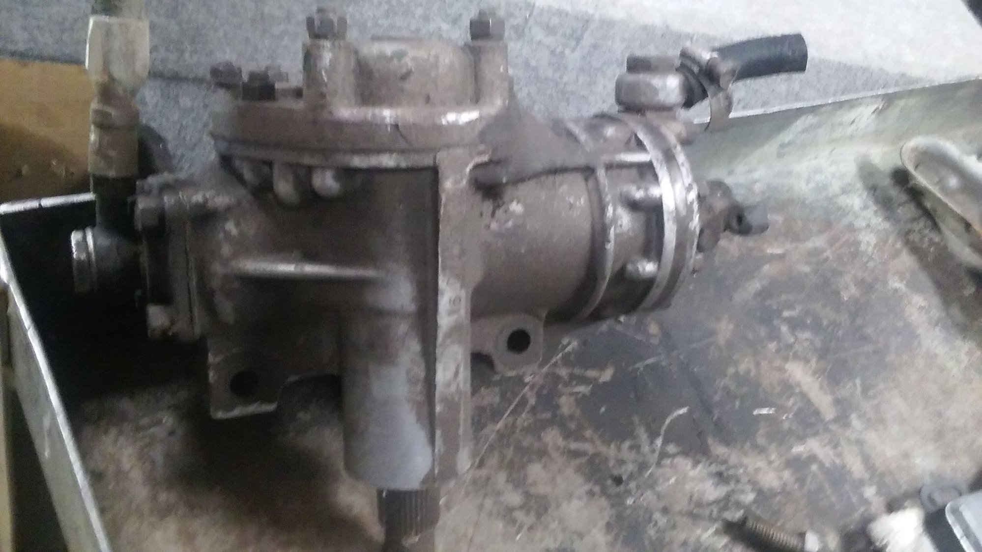

a guy in north oregon, in troutdale oregon to be exact, sold me this power steering box....i dont think it will fit my 1964 3.8S

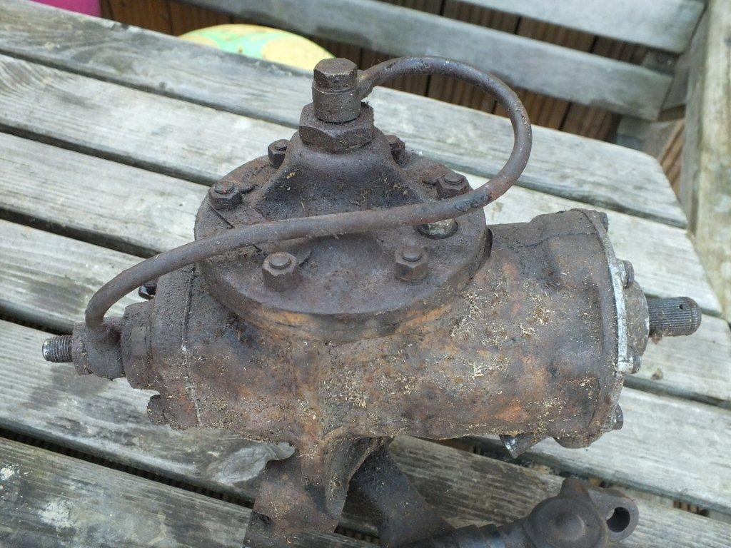

Does not look like a Burman type 1 or 2 or the Adwest Marles that was fitted to the later cars and the 420. The distinctive area to look at is the top sections. Burman is round with six nuts surrounding the hydraulic pipe and cap. The Adwest has an almost square top made from Alloy and has four bolts heads
Below are pictures first of the Burman. Type one and two look the same. Second photo is of the Adwest marles Variomatic for you to compare it to.

turns out the PS gearbox i obtained is a right hand drive unit from a Mark 9 Jaguar...will not fit my 1964, 3.8 left hand drive model.

Yes ~ cass is correct. It's not a Burman Type1 or 2 or a Marles Bendix Varamatic (Adwest) PAS Box. Has very different mounting points etc. No good for a mK2 or S Type.

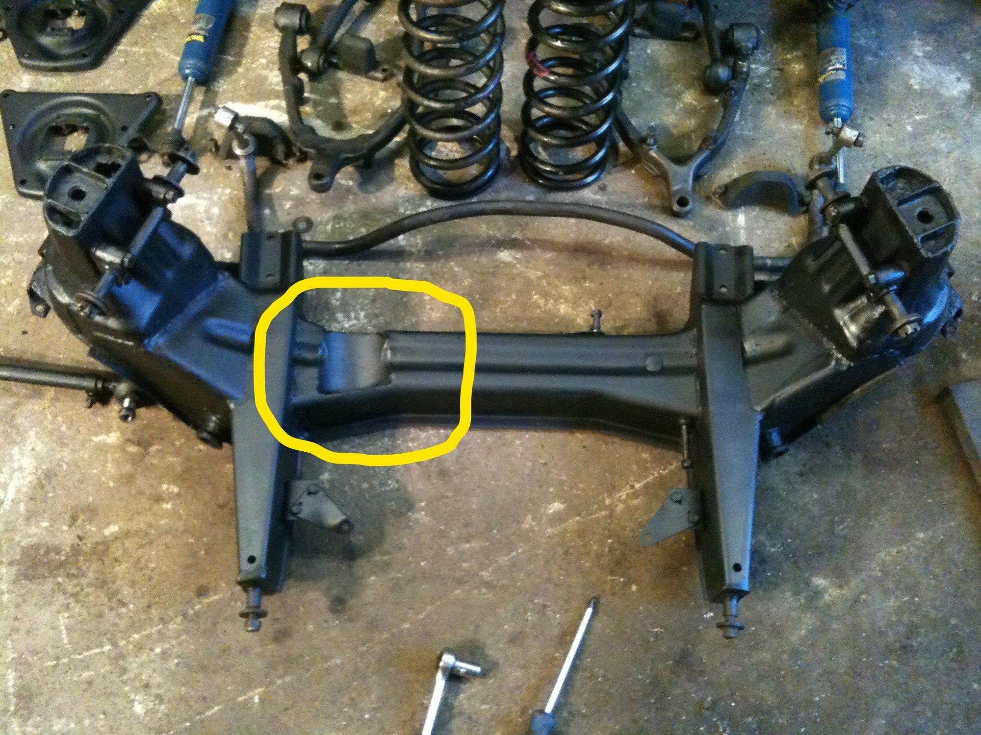

If you are looking at putting PAS on your 64 3.8 you would do well to look for the PAS from either a late Mk2, in the UK they were known as the 240 and 340 with the thin bumpers or from a Jaguar 420/ Daimler Sovereign. These were all built between 1966 and 1969 and were fitted with the better Adwest Marles Variomatic steering box. You will require the full front subframe as the Adwest requires a dimple cut out of the subframe cross member to allow it to sit correctly or you can have a competent mechanic cut and weld a dimple for you in you original cross member.
This is a photo of the front subframe from my RHD 1968 S Type showing the dimple for the Adwest PAS circled in yellow.
