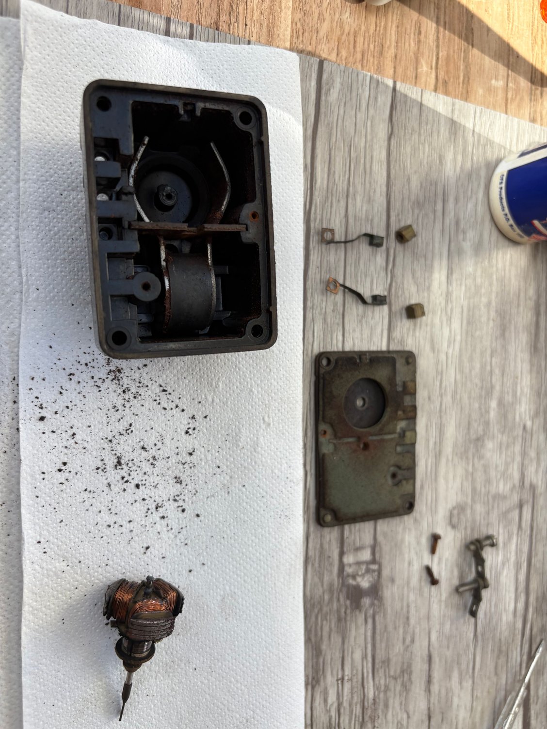

I have the original plastic reservoir. I have just taken the pump motor apart and cleaned everything.
Motor sounds much better now but still no real pressure.
I guess I will have to take the dash top off and try to remove the nozzles (tried a needle but didn't help), then replace the tubing.
Just tested it in the sink and the pump does a goes job, plenty of pressure.
