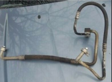

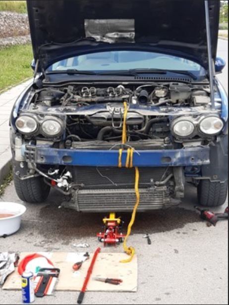

I finally managed to replace my AC Hose (C2S27012) on my Jaguars X type 2.0D. Its mentioned in the repair manual how to remove the AC Compressor but not the Hose, so I had to drop down the Radiator half way and remove the EGR Valve and related hoses to reach the ac hose since it curved and passes to the front of the car. Very tight with little room to work. If there is better way, please let me know. Below some pics.
