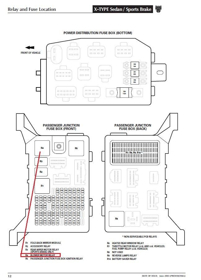

Hi guys, having trouble with the aircon blower, (not working) and subsequently no aircon, suspect the relay is "kaput" or "cactus" but can't recognise the unit in the fuse box. any suggestions?

Old Nov 23, 2019 | 08:13 AM

Is this the one you want?
Follow this link https://www.jaguarforums.com/forum/x-type-x400-14/ to the X-Type forum for help, advice and information. The 'HOW TO' thread at the top is a good place to start for information on regular issues.
