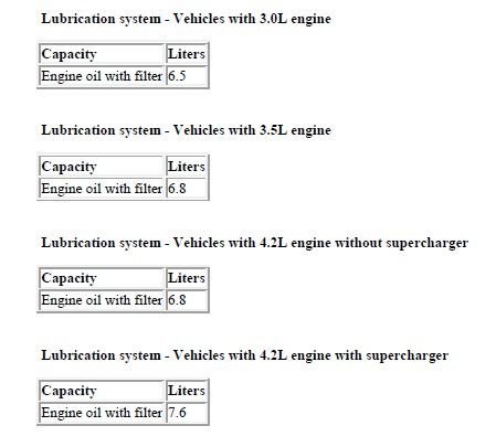

How many quarts of engine oil do I need to change the oil and filter of 2008 xj8l

Welcome to the forums jadejare1945,
From the Workshop Manual:
