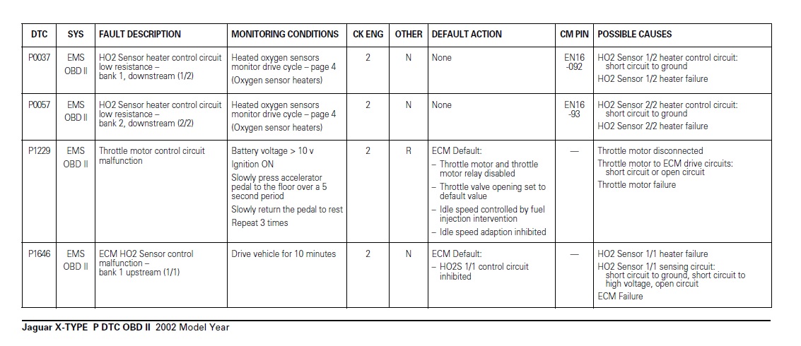

Hi my name is Juan I'am from Guatemala I have a jaguar 2.5 2003 my problem is when the car gets cold give's me the problem that wont rev up more than 2000 rpm and giev's me the codes P1229, P1646, P0037 and P0057 could you help me with this and thank you for let me join

Here's the possible causes from the Jaguar DTC lookup for your list of fault codes:
For further information, follow this link XJ XJ8 / XJR ( X308 ) - Jaguar Forums - Jaguar Enthusiasts Forum to the X-Type forum for help, advice and information. The 'HOW TO' thread at the top is a good place to start for information on regular issues.
