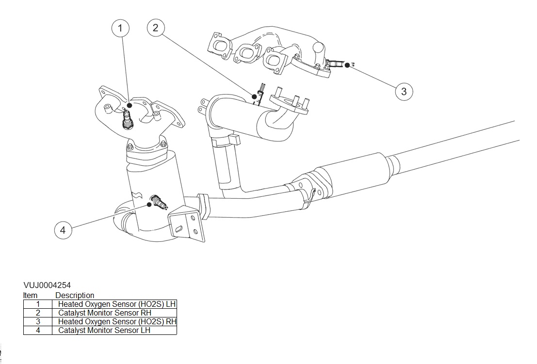

Hi...the lambda sensor (bank 1 sensor 2) needs replacing on my 2001 2.5L x-type....where excactly is it located....do anymembers have a pic of its position?...thanks guys.

Welcome to the forum gregster,
Here is the sensor layout. Members in the X-Type forum will help with the removal procedure:
