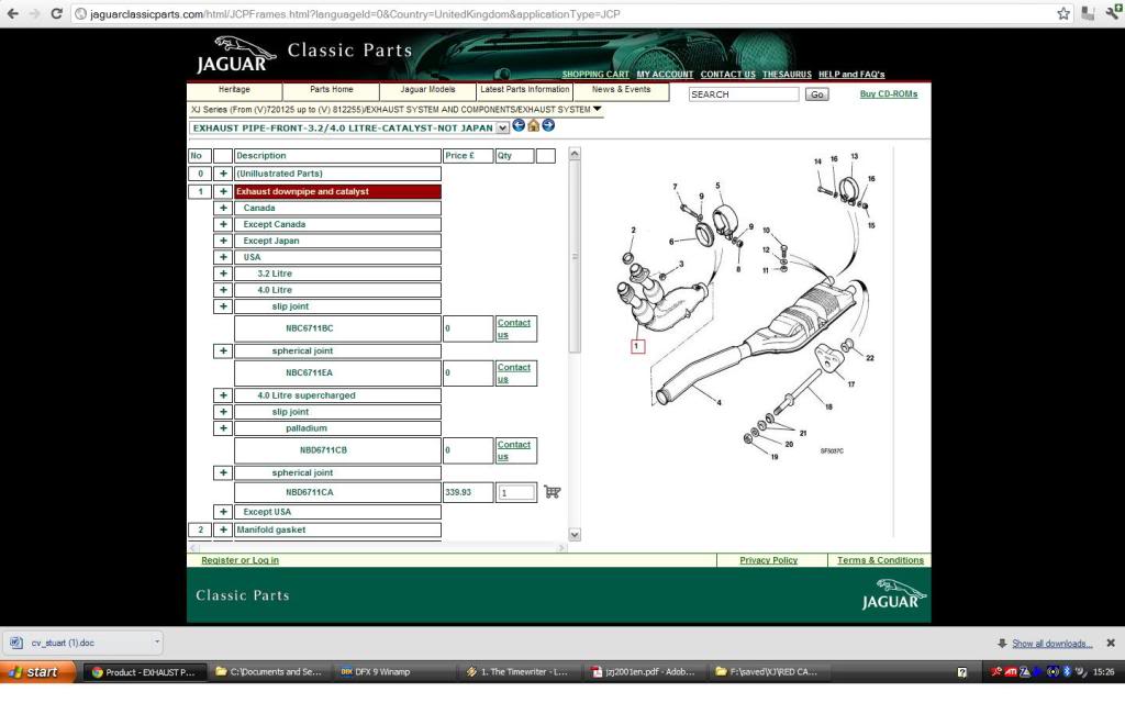

Not being funny but have you looked here?
Genuine Jaguar Parts and Jaguar Accessories for Classic Jaguars
The website above is Jaguar Cars Ltd own classic parts website, giving all part numbers for the X300 and recently added X308 - they list a USA spherical cat for £339, not $3,000!
Any part ordered through this site will be delivered and supplied through your local Jaguar Dealer, yes in the USA too - the website has a page about how Jaguar are making it's presence felt with this aspect of parts supply through the dealer network within the US,
sometimes it's best to contact the people that actually made the car, in England, just saying.....

Heh heh, I was sorta right and sorta wrong. It isn't a stretch at all.
In reading the service manual and "tech specifications" guide, the *only* difference mentioned relative to cat converters is that the supercharged cars used a converter with a shorter down pipe to clear the transmission.
I'll keep digging for more but if that's the only difference then, again, I think any exhaust shop could tweak things for a correct fit
