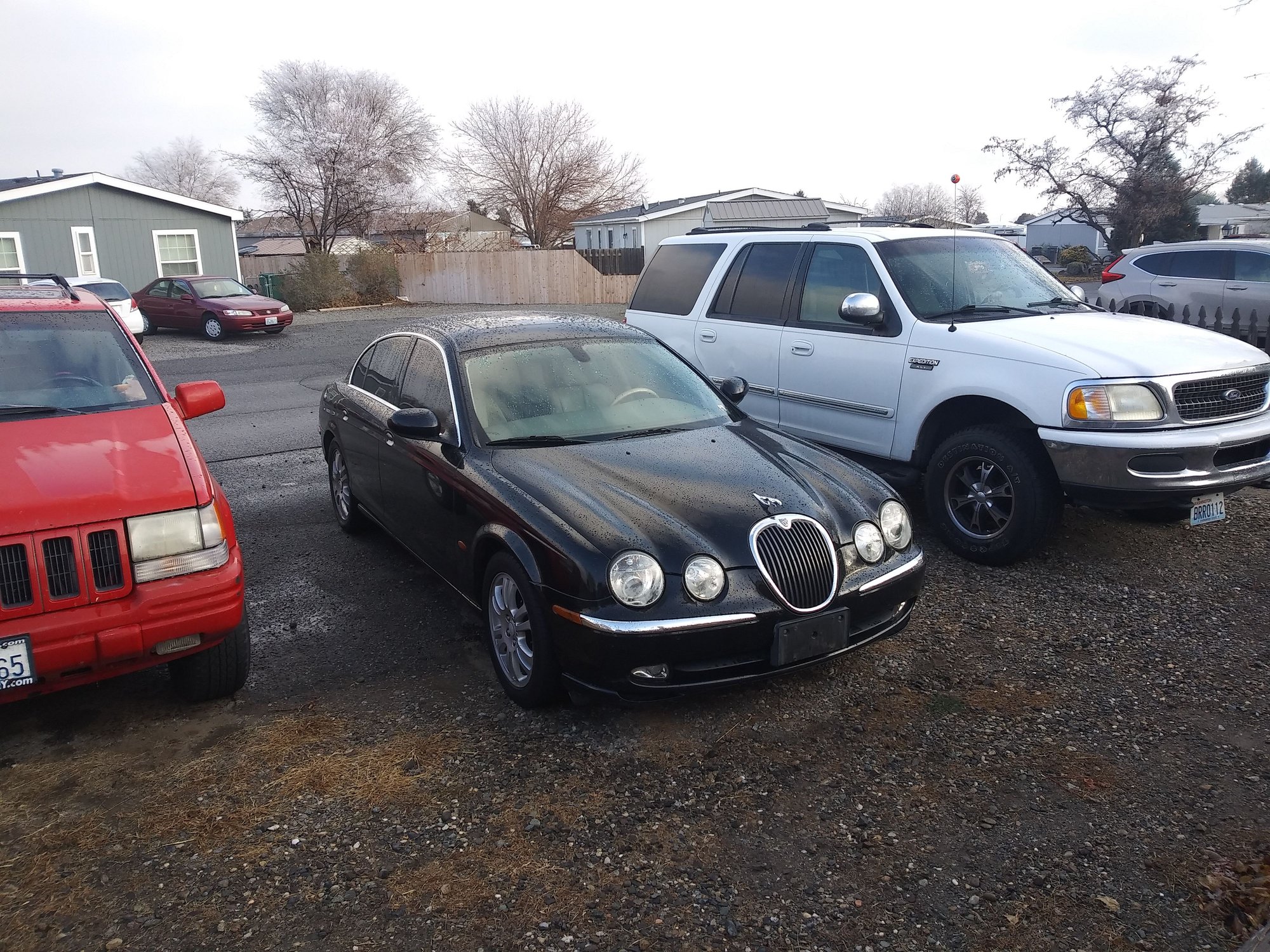

My name is Donny
Just just bought my wife a 2003 S-Type 4.2
119,000 miles
3 prev owners
Well maintained
The car came with one manual key, but no key fob.
The rear-view mirror is off but the mount is glued to the windscreen so I'm wondering first of all, how to reconnect that assembly. It is the automatic version with the cable and connector...
Also my wife was wondering how to connect a telephone...
(I'm reading through the manual as I type this)!
Cheers! Thanks for having us. Hope to learn much.

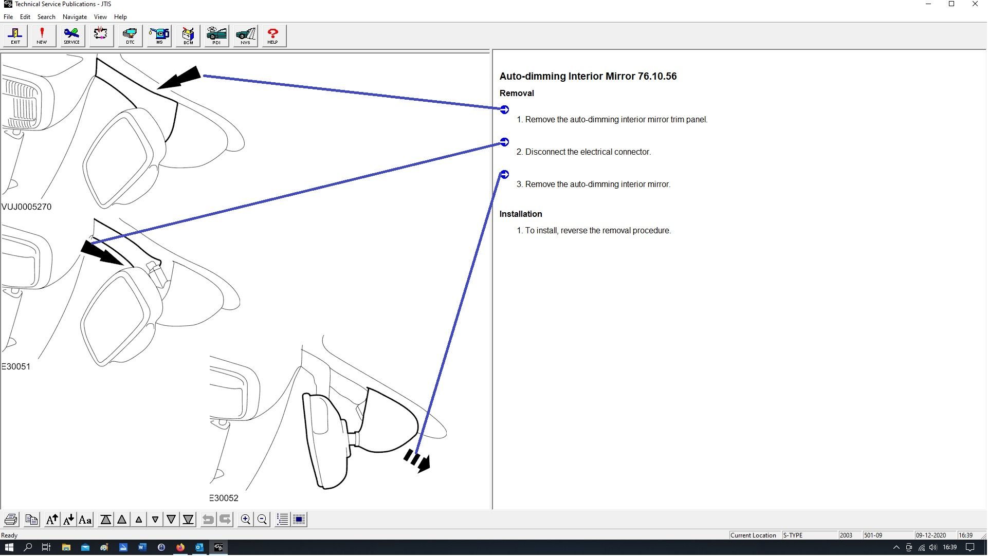

..... The rear-view mirror is off but the mount is glued to the windscreen so I'm wondering first of all, how to reconnect that assembly. It is the automatic version with the cable and connector..... Also my wife was wondering how to connect a telephone.....
Provided all the parts are present and undamaged, the mirror head should slide upwards back onto the mount and lock into position:
