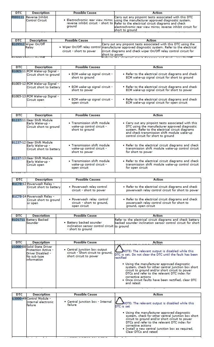

Hey Chris,
I got same same problem like you. Central locking, Wiper On/Off Relay does not work. Can u help and tell me how did you solve this problem? I have 9 trouble codes:
P0801-11, B1095-12, B10E5, B1237-11, B13D3-11, B1C7, B1D17-11, U1000-00, U3000-49
I will be glad for any advice.
Nyamaa
Old Apr 17, 2023 | 03:18 AM
Welcome to the forums Nyamaa,
Are you trying to reply to a post by a member called "Chris"? If you can tell me the member's username and if you found the post here in New Member Area - Intro a MUST forum or in the X250 model forum, I will move your question to the right thread.
Here is the decode for your list of trouble codes (all except B13D3 which I cannot find in the Workshop Manual:
NOTE - the common factor in them is GROUND FAULT.
Enjoy the forums.
