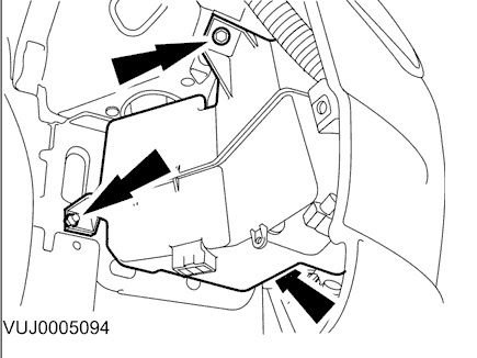

I want to replace the windscreen washer pump, but cannot remove the washer tank, 2 screws removed but cannot locate 3rd.
Any advice?

If the diesel is the same as the petrol models you will need to remove the wheel well liner for access.
Old Apr 17, 2019 | 12:54 PM
Welcome to the forums Kendojag,
As the tip of the arrow isn't even visible in this diagram of the fixings from the Workshop Manual, I'm not surprised you're having trouble finding the third!
