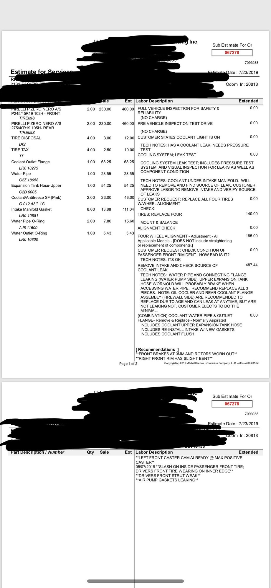

I did and here's what they sent. Just blocked my info as well as the info for the shop.

Worth a repost of the estimate in X351 forum for opinions from US members with the same model.
The parts required don't seem either unreasonable or unusual but I'd get a suprise if my dealer quoted that labour figure. Jaguar publish times for all repair work and NY labour rates could be much higher than I'm used to in England so I wouldn't want to say it's unreasonable.
