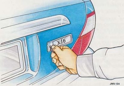

A quick check tells me: 35.3 X 19 X 17.5 CMs
Weight 23.4 kg.
You can drill a hole in the licence plate area and get the lid open.
Many X300s have this mod.
John.
