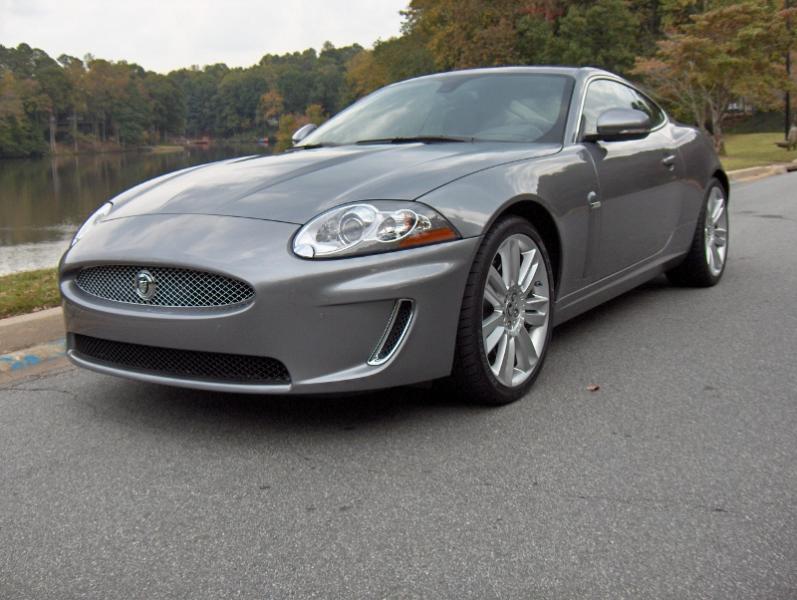

To be absolutely safe, don't get a Jaguar with the the 4.0 liter V8, then you won't have to worry about chain tensioners/water pump and whether or not they were up-graded. Get a 2003 or later model with the 4.2 liter or 2010 or later with the the 5.0. No worries at all with the two later engines. Don't be seduced by the low prices on the earlier (prior to 2003) models. There are reasons for those prices.
Attached Thumbnails Overlooked-20101012_13-800x602-.jpg   Overlooked-600x452.jpg
