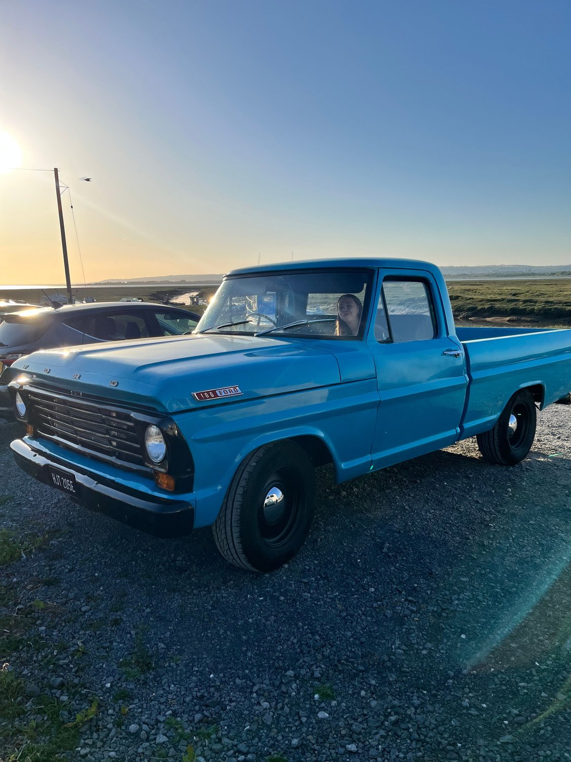

Not posted for a while…. Been busy !
Old May 23, 2025 | 05:21 AM
  #37
Scottsgreenjag's Avatar
Joined: Dec 2014
Posts: 282
Likes: 105
From: Somewhere south of Grand Rapids, Michigan, USA
Nice! How much weight do you have to put in the bed to keep those tires on the road. I’d bet it’s pretty easy to smoke them… Have you put it on a dyno to see what it puts out at the wheel?
Old May 23, 2025 | 09:55 PM
  #38
89 Jacobra's Avatar
Active Streak: 30 Days
Joined: Dec 2016
Posts: 6,141
Likes: 1,453
From: Arkansas
Hey David. Damn Nice Truck! Wow, sure came out great. Hope it drives as good as it looks. Give us some details as it wasn't nearly this nice last we saw it. LOL! Lots of bllod sweat and tears, I'm sure.
Jack
