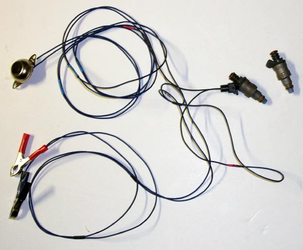

Over the past few days, I gathered up the materials to build a not-quite-patented "Cro-Magnon" fuel injector activation tool.
1 small roll 18 gauge electrical wire (need about 25 ft. or so.)
1 pair medium sized alligator clips
1 aftermarket fuel injector electrical connector
1 aftermarket horn button (giant economy size, you're gonna use your foot on it!)
Wired the hot side direct, put the button in the ground side ...'cause that's the way the injectors work. Power all the time, activated by the ground.
Cobbled everything together and gave it a try.
Initially tried using my battery charger for power, 'cause I was uncertain of the amperage requirements.

25 feet of wire and a giant horn button, for 'Cro-Magnon' injector testing.
Must be worth a pic!

.....25 feet of wire and a giant horn button, for 'Cro-Magnon' injector testing.
Well, it ain't much to look at, but here ya go:
LO-TECH REDNECK FUEL INJECTOR TESTER
The wire length is probably excessive, but there were several factors to consider.
Both hands are gonna be busy with air hoses, cleaning fluid and whatnot, so foot control seemed like the way to go ... hence the oversized button.
Wasn't sure if I might end up using this in the engine compartment or whatever, seemed a good idea to make sure it would reach wherever needed.
The concept is simple. Straight shot from battery positive post to positive side of injector, ground from negative battery post through the button to supply momentary activation.
Worked great!
BTW ... the two dead injectors did not magically spring back to life, so I have two rebuilt ones on the way here. Supposed to arrive Monday.
