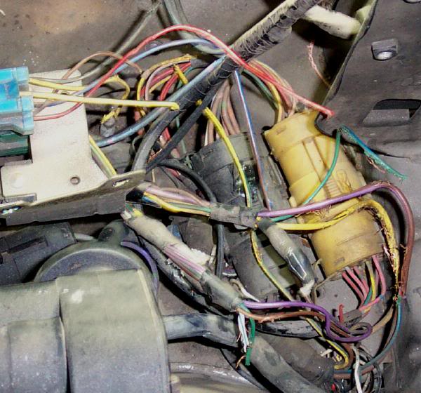

On another thread, I posted a pic of the engine compartment of the XJ40 when I first got it, complete with a fairly large field mouse nest occupying the battery tray.
I was happy to discover no apparent rodent damage when I cleaned it up, knowing first hand the propensity of the little critters to do major damage.
(Ohhh ..look! Mmmmm, vacuum hoses, spark plug wires! Go get the kids, Minnie!)
That has come back to haunt me.
Yesterday I decided to dive in and pull the air cleaner box and related components off the engine so I could attempt to track the various vacuum hoses, etc.
(That whole area is a factory supplied rat's nest!)
Under the air cleaner box & bracket were a bunch of chewed wires.
One of the relays affected controls the air pump for the EGR system. I don't know if this is the cause of my fuel problems, but it needs fixing anyway. Part of the EGR system is the fuel tank pressure line, so maybe this is the villain.
It might also explain why the dash readout was showing several fuse codes.
When removing the rubber elbow to the throttle body, I found the bellows to contain a puddle of raw gasoline. I'm still exploring.
The wiring repair looks like a real fun time!

I also found some old electrical tape on wires in that area. Could be some two-legged rodents involved too.

Old Sep 19, 2010 | 12:03 PM
  #69
Oh joy!
At least mice tend not to use wire cutters and so will leave frayed ends for you to play with.
Mind you, this being a Jaguar, don't assume that the two bits of broken yellow wire should be joined together.
I can't remember, if you have them, but you can download the electrical diags for your car from here.
Elecrical Diagrams. The link is also in the FAQ.
This could be a step in the right direction with your fuel problem. (finges crossed).

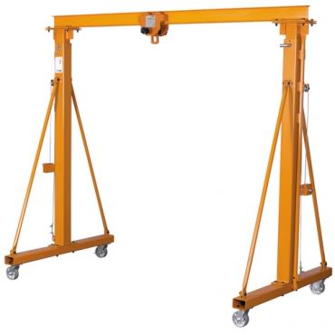

Instead I've devoted my recent efforts (sic) into getting my shop functional and purchasing and assembling tools and equipment I'll need during the project.
Got a spiffy new mig welder. No idea how to use it, mind you, but I've got it! Gonna contact the local junior college about taking their welding course. The last time I used any welding equipment in anger was 1964 ... and it damn sure wasn't mig equipment!
My most recent score was fairly critical to the project. Although my shop isn't tiny, it's not real big either. Since this will be a frame-up build, I needed a way to:
1) lift the body off the frame.
2) have both body and frame movable so I could shuffle them in and out of the shop as required.
So last week I picked up this little goody:
It's a 1 ton rolling gantry. Height adjustable from 8½ - 10 ft. Also got the matching 1 ton rolling trolley (as pictured) to hook up my chain hoist.
In addition, I bought a set of heavy duty 10" casters with pneumatic tires. I'll use them to build a mobile framework to set the body on when I need to get it out of the way.
So that's the status at the moment. I appreciate your asking, and I'll try to have a little more interesting update in the near future.
