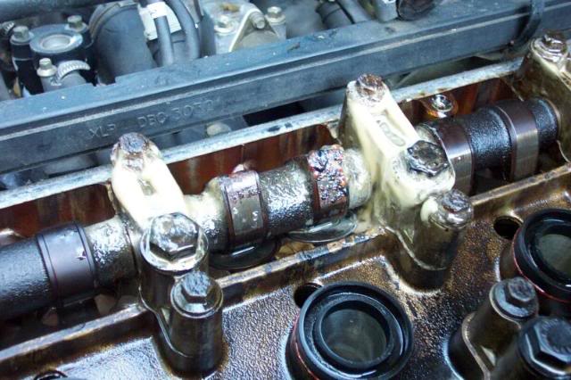

Before I went any further, I decided to investigate that mess on the intake cam. Here's a refresher pic from my other thread:
As I was hoping, the majority of that rusty mess on the cam lobes was sorta "in suspension" on top of the water & oil spooge. I wiped it off, then scrubbed the cam lobes with a brass-bristled brush and some WD40. There is some very minute pitting on the lobes, but overall it looks much better than I could have hoped.
Once I could get my socket firmly seated on the crankshaft bolt, a couple of moderate whacks with my dead-blow mallet got the engine to turn. I had put a couple ounces of Marvel Mystery Oil in each combustion chamber a week or so ago, that probably helped.
