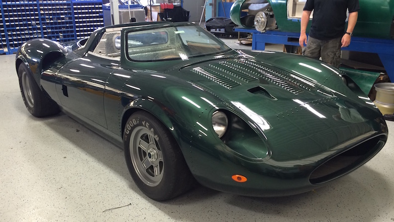

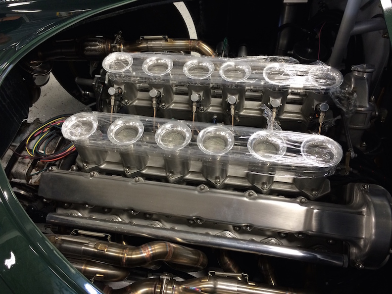

I've been away from this thread since building up a separate one to discuss my XJ13 replica project. That other thread has numerous postings by now that some may have missed if you're only looking here, so feel free to go over and see where we are with the build etc.
Fran Olsen of Fox Engineering built a fabulous injected V-12 and Race Car Replicas is in the final stages of completing the build. Details, pix and vids here:
