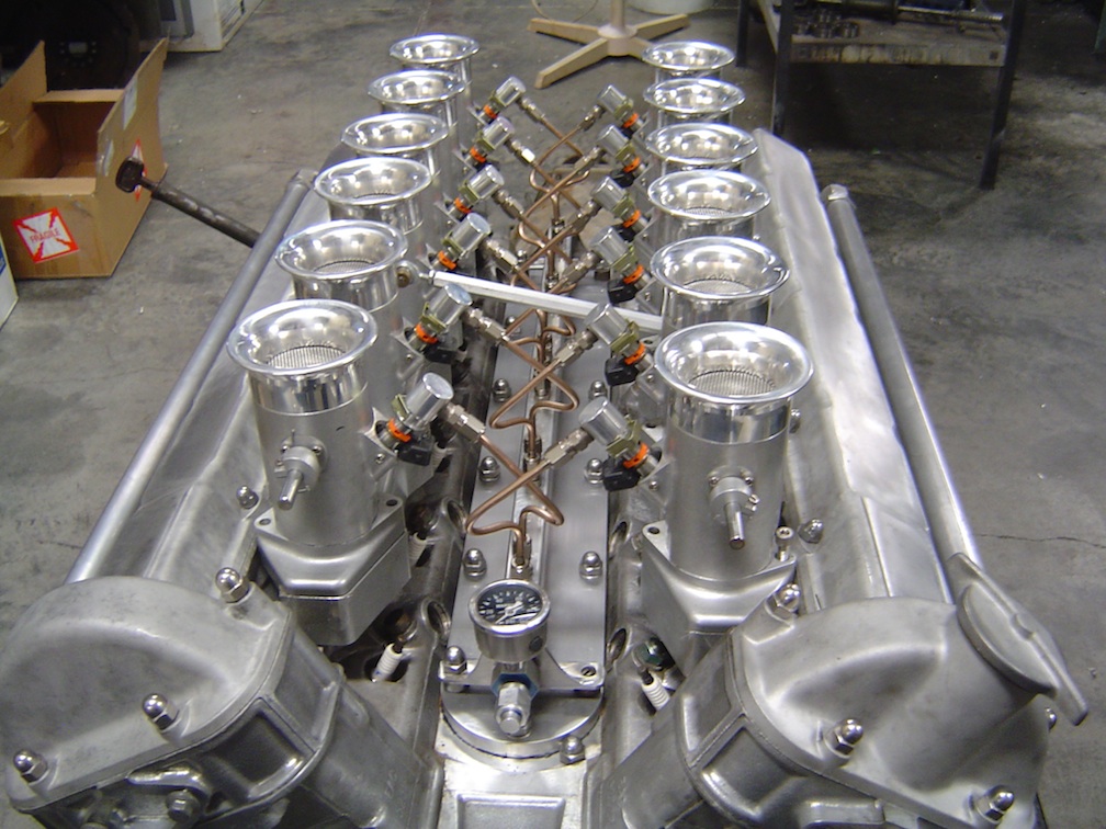

The magnificent engine has just been completed by Fran Olsen of Fox Engineering in North Carolina. (I know: two "Fran's"; how likely is that?!?). After much hemming and hawing, I decided to have a Jag V-12 produced for the project instead of throwing in a far less costly crate GM motor. In the interest of greater authenticity and given the fact that the bay is always on display with this car, true Jag hardware became a must. Fortunately I found Fran, who was beyond enthusiastic for the project.
He created a bespoke EFI system (Fox specializes in EFI for high performance and race applications), built custom velocity stacks and intake system, reworked the cam covers to match, and did a million other things for the fuel delivery that are way beyond my level of comprehension. He then mated it all up to a completely rebuild V-12 engine sourced from an XJS. A separate thread on this forum has more detail as well as videos and pix by Fran showing the running machine. See:

Attached Thumbnails Has anyone own or has build XJ 13 Jag-jag-chassis-reduced.jpg   Has anyone own or has build XJ 13 Jag-paint-1.jpg   Has anyone own or has build XJ 13 Jag-stacks-reduced-059.jpg   Has anyone own or has build XJ 13 Jag-engine-001.jpg

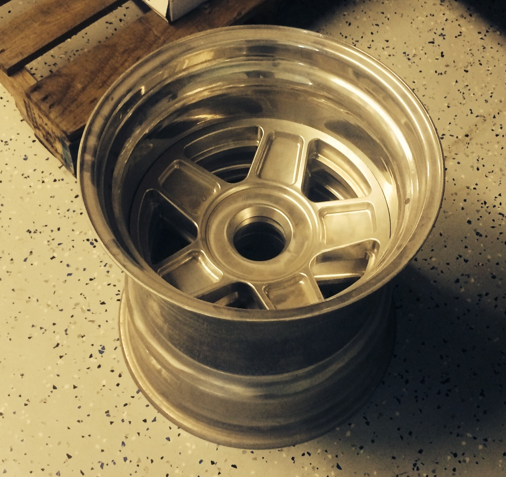

There was a previous question about the rims. Shown here is the final product: a set of billet spoke wheels bolted (not welded) to 15" hoops, then coated--all created and produced by RCR. Smashing to my eye.

It's aluminum bodied apparently, and has what sounds like some of the few OEM parts in existence (windscreen & rims). But any replica is just, well, a replica. That said, I hope they bid it up to $1M.
Speaking of rims, there was a question previously on this, so here is what we've got going:
Attached Thumbnails Has anyone own or has build XJ 13 Jag-rims-fran.png   Has anyone own or has build XJ 13 Jag-wheel-1.jpg
I am afraid their comment about "original XJ13 windscreen and rims" is nonsense and rather misleading. It is possible they bought some windscreens from Pilkingtons in the UK which were made using the original tooling. If so, they have me to thanks as it was me who prompted Pilkingtons to rediscover them! They were eventually found at their St Helens plant. I wrote a bit about it on my blog here - Triplex Laminated Windsceen Anyone can buy a windscreen from them but it is important to be aware the original screen was asymmetrical left-to-right. Not by a lot but enough to make fitment a problem if your opening is symmetrical.
Jaguar weren't aware the tooling had survived when they rebuilt the original in 1972/73. Their car wears a rather poorly-fitting plastic (acrylic) screen to this day.
The wheels on the Australian replica definitely didn't come from Jaguar.
Your wheels look excellent Scott :-)
