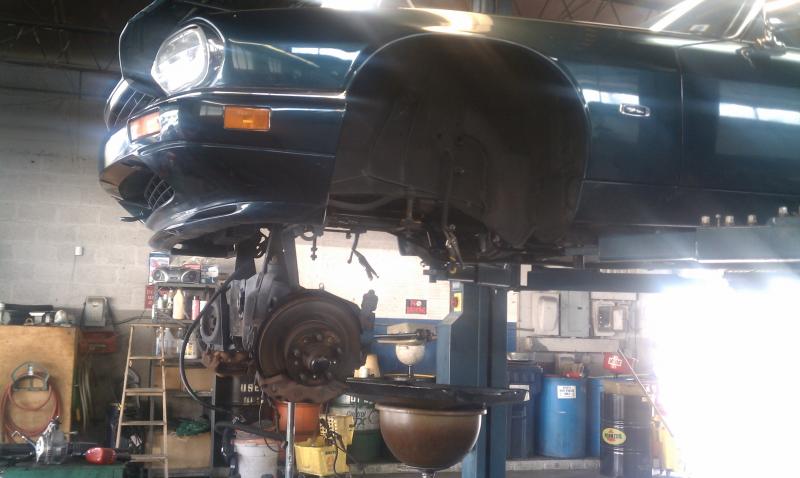

Just did the oil pan on an XJS and hanged the subframe, already put it back together but took a pick with the subframe hanging cause it was kinda cool:
DONT TRY THIS AT HOME

Nice. Looks like she's not enjoying this operation one bit! lol
Was it a leaking gasket?

no, the drainplug fitting was broken, the first pans had very little 'meat' around the plug, and the plug is a 30mm so somebody had broken it and j b welded it, but it started leaking. the new pan has more meat on the plug.
