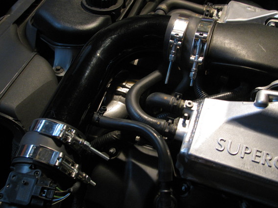

Finally uploaded some pics of my Mafioso install with the T-clamps.
The clamps are rotated in a manner that allows the hood to close and the plastic engine cover to be refitted. There is very minimal contact with the T-clamp and insulating hood liner - I noticed two little slits in the liner from the top of the clamps on the manifold side. To address this, I simply flattened the top of the T-clamps. They have sharp little protrustions on each side, a few quick taps with a mallet and they are flat and no longer poke the insulation.
I also added a hose clamp to provide additional security for the PCV hose barb connection on the valve cover.
So far very pleased with the intake! Looks good, sounds great.

I'm on the fence about the clamps. Trimmed up would be better for sure.
The only one that I wouldn't put a worm drive clamp on is the top one on the manifold side - it mates the oval shaped manifold intake to the round Mafioso intake. It took a good bit of crankin' on that T clamp to make me satisfied it was a good sturdy connection.
I might paint the clamps black.

I am very confident there are no air leaks with these T-clamps. The clamping force is very good, the clamps are wide, and the rubber connectors are very snug on the intake and manifold sides even without the clamps. If there is any unmetered air sneaking in there, it ain't enough to do anything IMHO.

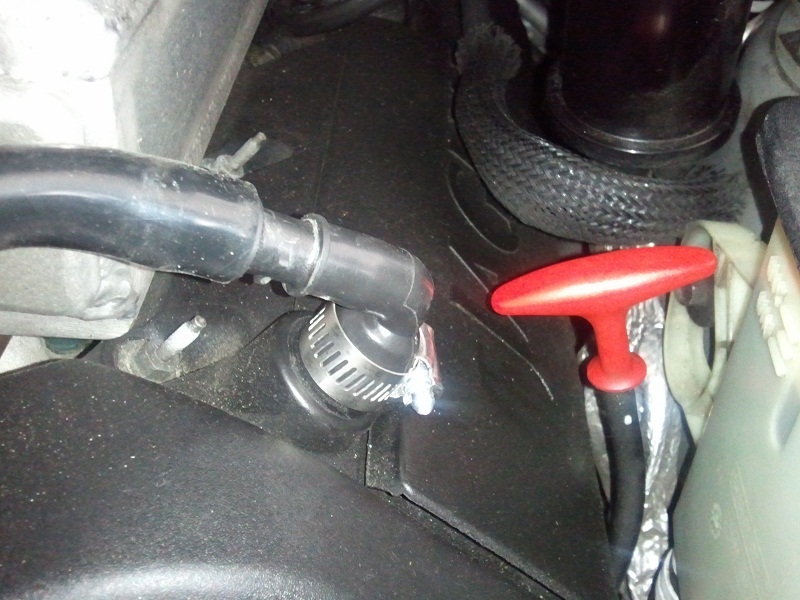

I put a worm drive hose clamp on the vac line from the valve cover to the intake. This is where some had reported the rubber fitting had split.
You can see the fitting in this pic on the right hand side. It has a zip tie on it in this pic, but I replaced it with a hose clamp later on.
Attached Thumbnails **official** intake elbow group buy thread-intake-2-.jpg

Here is a pic of it clamped. I did this after mine split and I got a new one and its been fine ever since.
