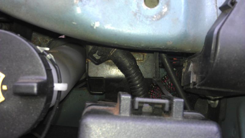

Good thought 666, leightos, can you take a picture of the mystery box?
Old Dec 3, 2011 | 05:34 PM
  #37
leightos's Avatar
Joined: Nov 2011
Posts: 51
From: Australia
one photo is a wider angle to get perspective. the other is the closup of the box.
Anyway...new problem - now its been 17 hours and the battery is dead again. I'm gonna vomit!
funny thing is...another data point - I took out the key, and popped the boot and then hooked up my CTEK charger, and as soon as I did, all 4 windows went down half way.
I can't figure this out. yesterday the car went to sleep, on its own...totally to sleep. now dead again.
Attached Thumbnails *New* Battery Drain thread...-imag0009.jpg   *New* Battery Drain thread...-imag0010.jpg

is this the box in question ?
Old Dec 3, 2011 | 06:25 PM
  #39
leightos's Avatar
Joined: Nov 2011
Posts: 51
From: Australia
yes ...
but, you can imagine that I don't consider that the offending component anymore because its disconnected and the battery ran down last night.

but if its a part of an aftermarket alarm system the may be more parts, wiring, switches, that may be drawing power or stopping your car from powering down
