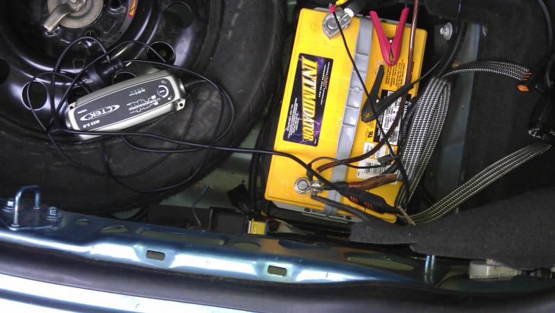

funny thing is...another data point - I took out the key, and popped the boot and then hooked up my CTEK charger, and as soon as I did, all 4 windows went down half way.

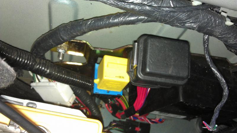

Update 3:
2 pictures attached - one wide angle of the boot - the other a close up of a yellow relay.
Now that the car has been shut off for 24 hours, and the visor lamp came on about 2-4 hours ago - that must mean the car has woken up
I used my hand to feel the RECM to see if its warm. Its not. I tried some componenets under the bonnet, including the mysterious box. Nothing warm.
But, this module in the boot... its very warm to touch, and I'm not sure it was like that before. This wiring in the back was attributed by the auto elecs to be part of the tow hitch assembly. They disconnected. i thought the relay was the same component.
Could this be the culprit? I pulled it and am waiting to see if the car goes to sleep again...tick tock.

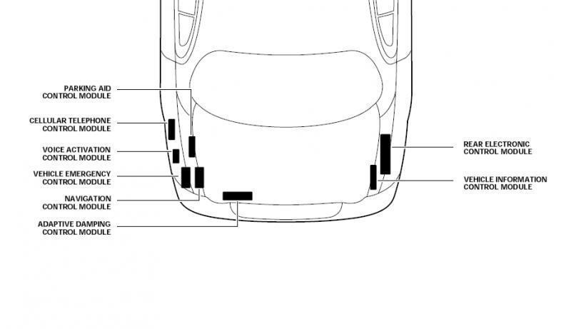

Hope someone posts pics of their 4.0 but regardless check the handbook & elec guide to see if what you have is standard. It doesn't look like it is but the 4.0 is not what I have. My 4.2 has a lid on each of the fuse boxes and what I see in your pic suggests there's no lid. May well have been removed when someone fitted what looks like an odd object. Doesn't have to be the source of your troubles but would be a top suspect.

I have good mates here too - one just lent me his lead acid battery from his 4WD to put in my car. I'm charging it now w/ the CTEK - will put it in in after it tops up.
Hi Gus,
I went through the elec guide earlier and didn't find the module. As you can see by the picture in my earlier post, it is the yellow relay only that was quite warm. Its located in the middle of the boot on the wall along the bumper about where the license plate is - its part of a black unit about the size of a deck of cards that has a big Ford stamp on it. The auto elec said it was related to the trailer hitch and assoc wiring.
Hi Gus,
