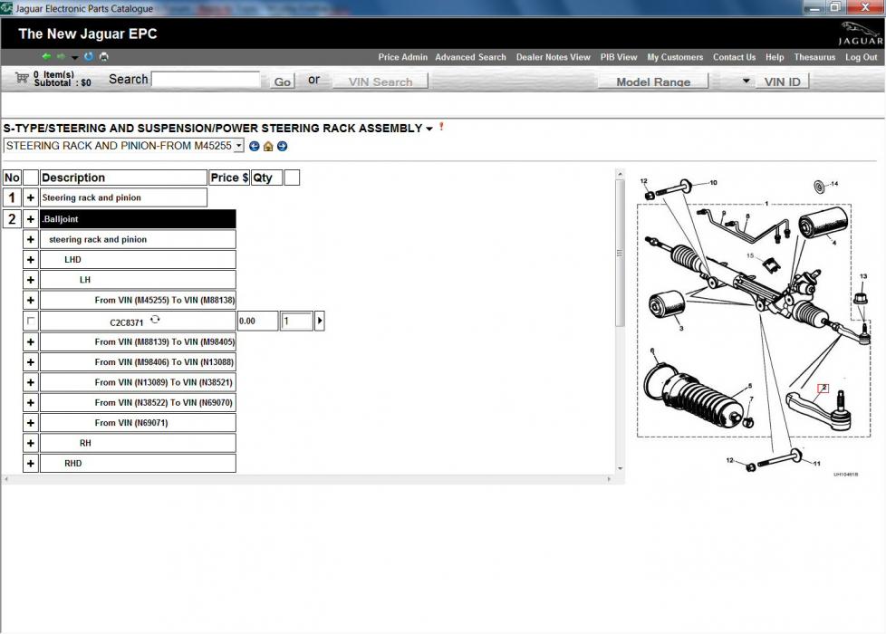

Had my 2003 S-type for wheel alignment and was told that it needs a front left tie rod to be replaced.
Did anyone had it replaced before? and if so can you provide the part number and its availability? Thanks
Inner or outer??
The outers (with the ball joint) are available individually.
The inners (attached to the rack) aren't available separately from jaguar. They come as part of the steering rack assembly. Ken @ brittish parts and a couple other people DO sell them separate though.
See Below for info:
Hope this helps
Take care,
George

Thank you George it helps a great lot! I will print the material you sent and take it to the workshop tomorrow. Thanks again!
