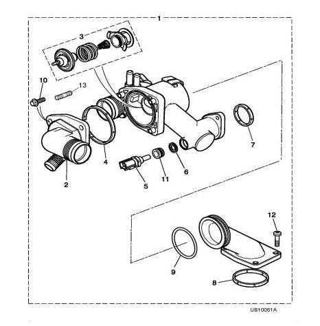

The leak is in the casting seam in the piece directly behind the thermostat and I assume, from this image I captured somewhere on the web, that this part is called the 'water outlet pipe'. It must have been a pin-hole leak just waiting to expand, as now it is quite a 'squirt' of fluid.

I pulled off the engine cover to see what would be involved in the replacement, as I am at least quasi-mechanical. What do I spy, but the attached photo.

Pretty common failure and many DIY guys have changed it. Just be aware that the car is now over 10 years old and ALL the plastic will be weak and decayed.
Do some searches for instructions and for other parts to change at the same time. Kind of surprised the dealer did not find it because as I said it's a common failure.
If you don't want to DIY, then it also doesn't have to be a dealer. Any mechanically-competent shop could do it. Main thing is to top up after with the right kind of coolant (because the wrong stuff gels and blocks everything up).
