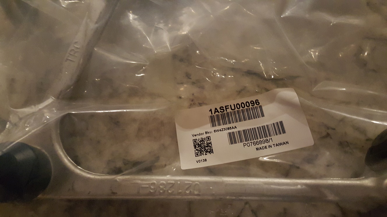

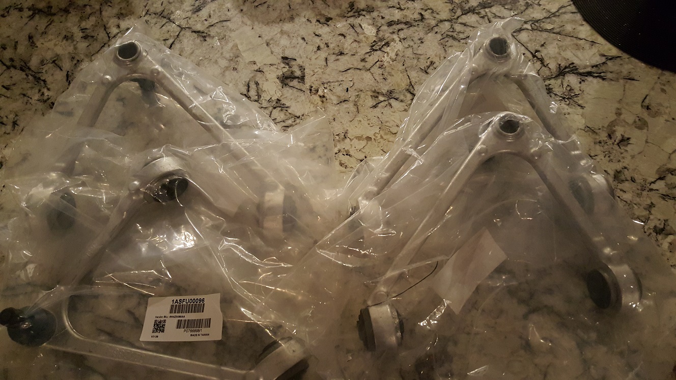

My upper control arms arrived today. Not Lemforder. Instead they are made by TRC / Rung Cherng Suspenparts.co - the Part numbers are not listed on the internet and I couldn't find the a-arms listed in any of their catalogs. When I get a chance I'll compare them more closely with one I replaced. I am wondering about the alloy used and if they are manufactured by the same process. Visually, they look exactly the same as Lemforder castings, just different numbers stamped on them.
Attached Thumbnails '03 ST Upper Ball Joint Dust Boots Torn Up-trc-arms.jpg   '03 ST Upper Ball Joint Dust Boots Torn Up-trc-control-arm.jpg

The new uppers are still sitting on my parts shelf. I purchased them for spares. My cars don't really need new uppers replaced yet.
I wrote the manufacturer a couple of times and they never responded.
I will write again, a third time.

Update on Upper control arm material and fabrication.
TRC replied to my E-mail. Not as much detail as I would like, but they did answer several of my questions.
1. The TRC Upper control arms are fabricated using 6061 Aluminum followed by the T6 heat treatment. (The majority of Aluminum suspension parts are made with 6061 alloy)
Through internet searches, I am confident that Lemforder aluminum suspension parts are fabricated using 6082 alloy. My understanding is that 6082 is very close in composition to 6061 and is used primarily in Europe. – 6082 has a bit higher ultimate strength, and is a bit more brittle than 6061 – You can look up the properties if you want to get into the nitty-gritty differences.
Note: In 2008 to 2010 timeframe other alloys have started being used for suspension parts. A356 and B-206 alloys. I wonder if Jaguar uses any of the new materials in their latest generation suspensions.
2. TRC states they use the same fabrication techniques as Lemforder. Not sure if the upper control arms are made from a casting, pressure casting, or forging. They are likely made using a PM (permanent mold)
3. TRC sells this control arms to many part supply houses that warranty the arms for 5 or 10 years. (I suppose if one breaks, you would go after/sue the importer/part supply house.)
4. TRC has been in business for over 20 years. Searching the internet, I find references that they have had contracts with Honda, Hyundai, Mitsubushi, and Nissan to produce OEM suspension components. If they produced inferior parts, I suspect there would be complaints about their products. I didn’t find any.
5. This is speculation, but I found many references that Lemforder is having many of their parts manufactured in Taiwan and China. There is the possibility that the Lemforder Jaguar parts come out of the TRC factory. (I suppose we could write Lemforder and ask where their Jaguar parts are made.) – If Lemforder parts are in fact made from 6082 alloy, this supports a higher probability that they are made in Germany.
6. For readers concerned that non-oem suspension parts are inferior to OEM or Lemforder, there is a low probability that TRC part will perform, fail or operate differently. For all I know, perhaps the bushings and boots are higher quality than OEM.
7. Searching on upper control arms for S-type Jaguars, I found a third "unbranded" control arm. I wonder who makes this one?
