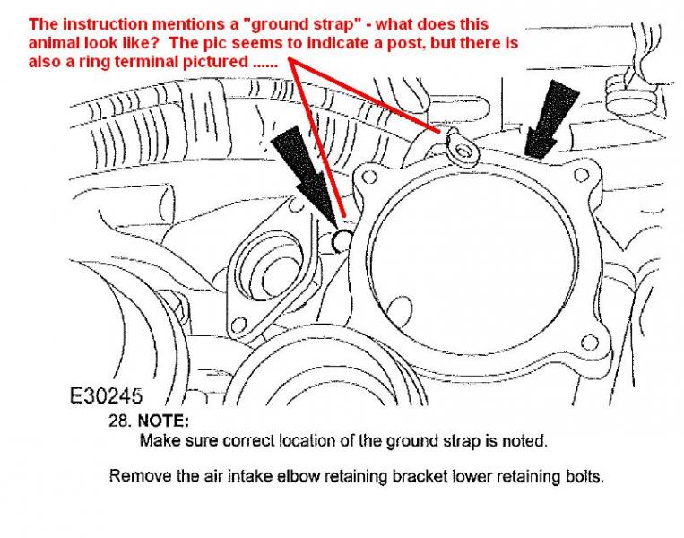

Old Mar 7, 2012 | 05:56 PM
jar's Avatar
jar
Joined: Mar 2010
Posts: 91
Likes: 5
From: North Carolina
So, as I think on this, I come back to step 28 as well - see the attached.
Is this referring to an actual "ground strap"? What I would typically think of as a wire lead, with ring terminals, bolted down to something?
I don't believe we ever saw anything of such nature when going thru this ordeal. We took the "strap" description to mean the bracket that holds the air intake elbow.....
Anybody familiar with this area or this item?
Clarity here would proally be a good thing, as it feels like I'm chasing ground/electircal issues......
