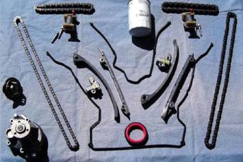

Timing chains are superior to timing belts. Car manufacturers use belts for two reasons. Cost and noise. I really think with an interference engine it is short sighted to use a belt.
But these days it is MUCH more common to use a belt. In the years past before OHC engine were common all cars pretty much used chains or gears. In fact for racing gear drive conversions for the older American V-8 cam in block engines are very common. When the move to OHC started this increased the length of chain and the complexity of where it has to travel. Take a look sometime at how the S type DOHC timing chains are laid out. With primary and secondary chains and tensioners. Also Jaguar is now on the 3rd generation of tensioners for the 4.0-4.2 L engines. So for Jaguar they have spent a good bit of time and money getting the tensioners to where they are now. This 3rd generation seems to have fixed all of the earlier versions problems.
Here is a picture of what is required to replace the parts on our S Types. Pretty complicated!!
