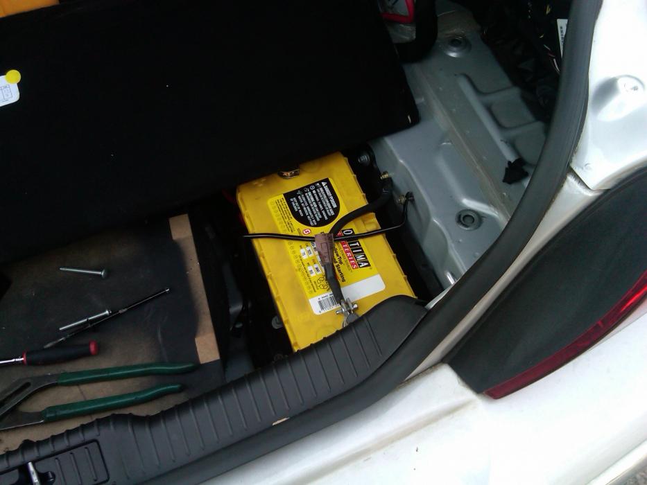

Riski - why did you pick the red top? I went with the biggest yellow top that would fit. Helps a bit with my aftermarket stereo. Had to bend the stock battery support in a vice to get it to clamp down right.

Originally Posted by Kapitan1975
wait... wait you guys..
we can use Optima on STR?
the guys at Autozone did not want to sell me the battery since it doesn't fit my STR.
can you help me with the spec on the optima.
or any kind will do?
I have the biggest yellow top beast one that will fit. It also has the posts in the right places so you can use the factory cables without modification.
You DO have to modify the factory battery hold down, but you can bend it in a vise to get it to work, see my picture for details.
