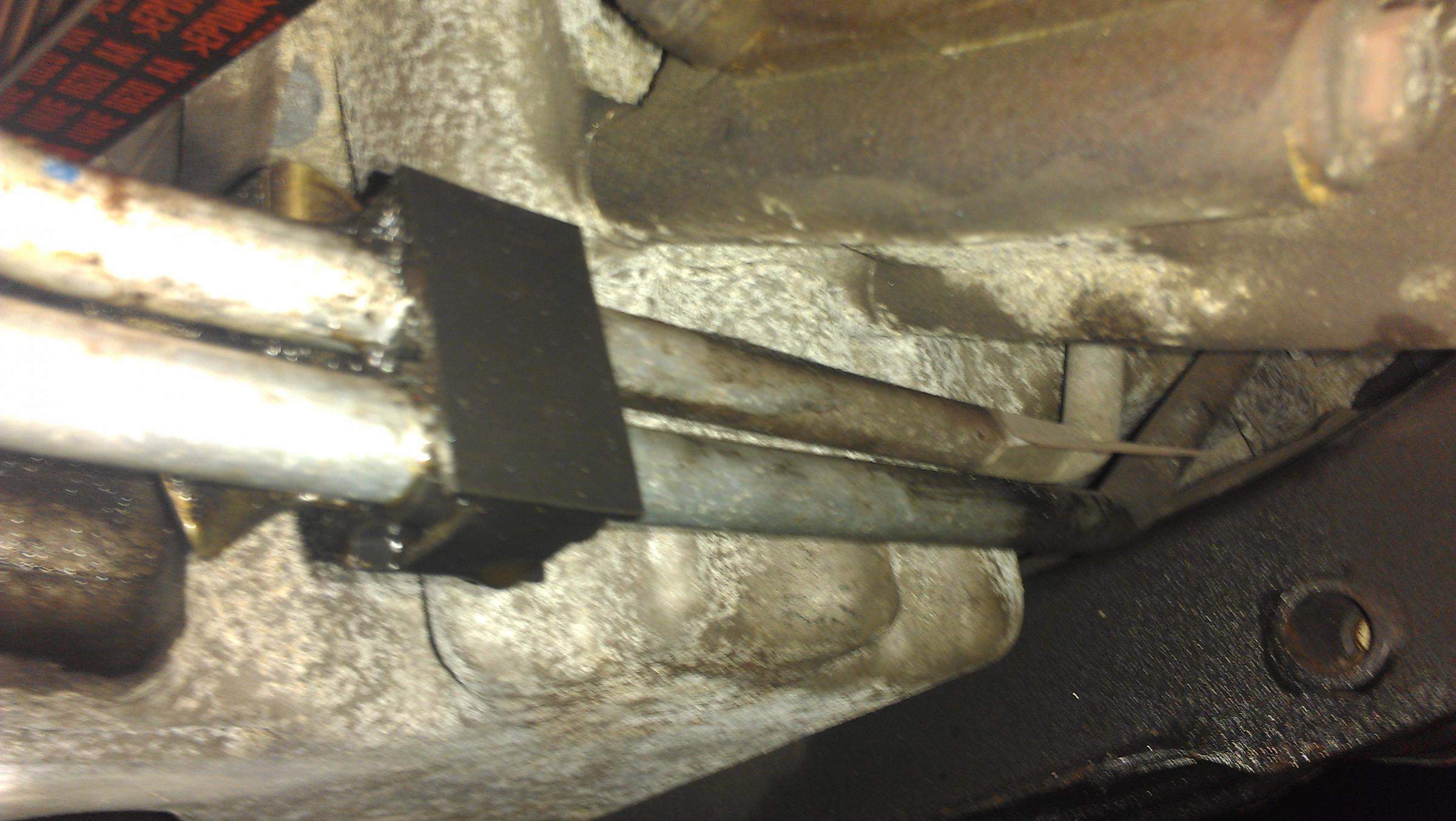

I think I have the same problem, but not sure, so I took a few pics and hope to get some info on the piece that simply looks like a bracket to hold the two lines???
Is this just a bracket for the two "one-piece" lines, or does it join four lines?
There is fresh fluid at the bottom of the black plastic bracket piece...
See attached pictures and thank you in advance for your knowledge!!

I did some more searches around the forums and found out that our lines going to the trans cooler are one piece.
So this black plastic piece is just a bracket.
Usually the lines leak at the rubber to metal crimp?
I checked those areas and the lines look bone dry...hmmm
I will look some more in the next couple days to see if I can find any pinholes or areas where the leak could be coming from.
I wonder if some sort of epoxy could be applied to the outside of the line with a crack/pinhole in it instead of replacing/cutting out?
