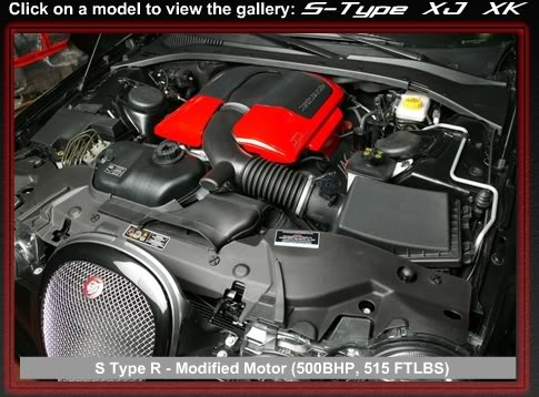

Okay so I am at work browsing the web and I came across Eurotek Designs website again... I've been on here before, but I guess I never paid much attention to the details.. Here are some pictures I borrowed that really get me thinking... A larger intercooler? A chip that allows the R to hit 169mph? 500hp and 515ft/lbs of torque?
I do not know how I did not notice these things last time I was on here, but the intercooler and ECU really make me want to give them a call....

I would also love to know where they found 500 horses in this motor? I guess it must be more or less stock (No Kenne Bell or anything crazy) just pulleys, a tune, maybe porting.... Anyone have any insight?

What year is that STR is the bottom picture, the "ram air" intake seems to be smaller than the one on my 2004. Nice red engine cover. I have read that Mina Gallery offers a small pulley that adds about 1-2 lbs of boost, this should be good for a more HP & TQthoughout the RPM range.

I doubt you can get to 500 bhp with a Eaton on a 4.2 car. First of all a larger intercooler will not give more hp, it will only help to keep hp for longer before the system heats up and you loose dramatically. Next you would have to spin the supercharger much faster for more air, which will generate much more heat than stock, and it will be very inefficient, meaning it will cost more and more hp to turn the supercharger adding only less hp. The gains one could get with a stock engine and only do a ECU tune, cannot just be added on top of other modifications, as when the pressure goes up with the (h)Eaton, so does the temperature, so a specific tune is needed (maybe even a de tune). You could run the car much leaner (some tuners go pretty far here) for gaining some hp, and maybe as long as you only use it for short bursts you could get away with it, but it will be dangerous with continues usage (ie. German Autobahn). So imho one need to do much more to get to 500 bhp levels using the Eaton, maybe nitrous, I don't know.

The question is will a bigger intercooler give you more HP then stock in real conditions (i.e. driving on the street). Believe me the Jaguar 400 BHP will probably have been measured under ideal (ice cold?) conditions.
Of course cooler air will aid in extra power, so running a separate cooling circuit maybe even lines to the trunk with some ice water will help. But just normal outside air temps, and just a bigger intercooler on a stock car?
Not even tuners who sell intercoolers claim that they will provide more HP. Anyone who have done some dynos after another (and have measured coolant temp etc) can confirm that you will lose power the hotter the intercooling circuit becomes, but not gain more than 400 bhp just by adding a bigger intercooler.
So that is the base line if you see what I mean.
No need to come with theoretical statements (not meant negative), I have just done too many dyno tests to know what effect certain changes have on our cars, so let’s just say my words are my opinion, and you have given yours. ;-).
The base ECU map is indeed conservative, so there you can snoop some power (about 25 could be possible), but that would be on a stock car. As soon as you alter the pressure/heat, you risk getting into the pre-ignition area, so a special tune would be needed for your tuning package to try to get the most out of it, and that could mean again to enrichen the fuel mixture or even retard the ignition.
All doable, no rocket science, but I have not seen a tuner in the world that could get 500 bhp with a 4.0 or a 4.2 engine with the eaton (so about above the 400 rwhp). I do not want to discourage people, go ahead and try that is already half the fun, but I just want to provide some real experiences I have had that 500 bhp isn’t reachable easily with the suggestions given here, much more would be needed if at all (ok NOS will help).
Very important, make a good baseline dyno, make sure you already get the right HP numbers from stock before you even start tuning. Next ensure for the after dynos to keep the conditions the same, to name just a simple one: same tire pressure.
Andre.
