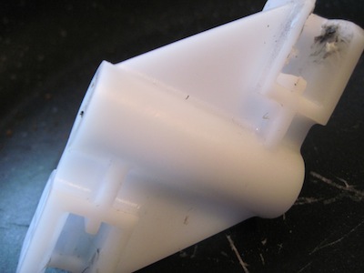

I just played jaguar mechanic and changed out the white plastic shifter block that can break if it gets stuck in park, So I'm told!
Will I can see why. They have a metal nipple for lack of a better word going onto a cheap plastic grove and it will grind the edges of the plastic over time. This is why the shifter lever gets to wiggle more as the car is driven more. I'd recommend the aluminum one! Remember this 2000 Jaguar 4.0 has 55,700 miles on it and there was some wear showing

Thanks for sharing. Pictures of the OEM would really be appreciated if possible.

As an Engineer I look at it a bit differently. It's a mechanical fuse. The safety joint that fails first to save more expensive stuff down stream. After all in the end a tow truck call is cheaper and quicker than fixing the transmission.
Should it lock in gear? Of course not, that's definitely a design fault. Seems like again the early cars suffer more from this? My 2005 on any surface has never had any problems. Including many steep drive ways and parking lots. With the automatic parking brake it catches it so the car does not load the parking pawl.

This part from Welsh inc is metal an only 65.00 and when I took out the black screws that held the bottom half of the console I was able to pull it back toward the back seat just enough to get the side side screws on th metal plate. I didn't need to remove the whole block enclosure to take out the white shifter block. There are two screws under the little insert thing just below the AC outlet in the back seat. They are all torgue screws in the console. For those that think you will break something with the metal part. If you go inside and to the back of the shifter you can release the shifter from a solenoid just under the back of the housing. if you pull too hard on the shifter I think the new metal block from Welsh could break off also, "be gentle"
