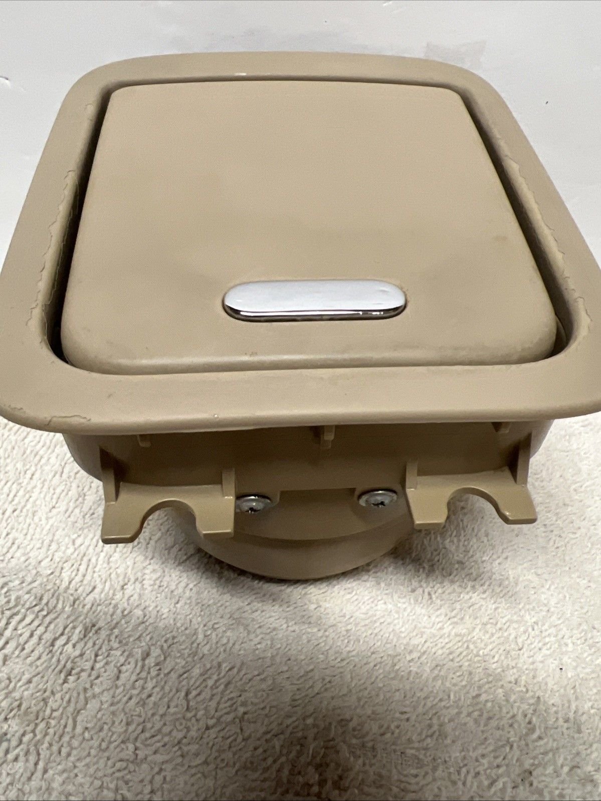

Another tip is for how to remove the cupholder. The front edge of the cupholder has two protruding tabs, secured from underneath by Tinnerman nuts. Technically, you're probably supposed to remove the entire console first and then remove these nuts. However, I found if you pry up on the aft edge, you can slide the cupholder aft just enough to clear the nuts. Don't pry up on the forward edge, as the tabs keep the cupholder from raising. Pry at the front and you can damage the cupholder. I do not care to discuss how I know this...
Here's another purloined eBay image, showing the protruding tabs at the front:
Hopefully these two little tips help somebody with an early model, stuck in Park at some inconvenient location.
